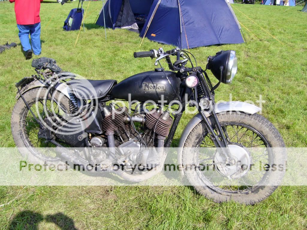

Well, I must say this is a turn up for the books. Although I havnt got as far as measuring up with a tape measure I didnt think this was possible. Obviously mucho chopping about has been done and the front downtubes leave alot to be desired but even so.....
No idea what the engine is however?? Seems to be 2 diferant cylinders and heads??

The engine is an alloy Mark 1 or Mark 2 JAP.
Aluminium cylinder heads,cylinder barrels,rocker boxes and magnesium crankcases & timing cover.

Tricky tree: not two different cylinders and heads, same one just one facing left and one facing right - the carbs point towards the center and the exhaust pipes are on the front and rear.
Overandout - maybe it's not your first choice of styling, but I think that BSA Jap, (JaPeeza?) looks amazing. Love the girder front end. Wonder iof that tank had to be cut to allow room for the cylinder head? Where'd you find that picture, were there any more angles?

"Yes" this engine does indeed use the same alloy cylinder head casting on both cylinders.
I recently looked at a brand new pair of these cylinder head castings when i visited MFC Patterns & Castings in Doncaster, UK. The website is at http://mfcpatterns-castings.co.uk
