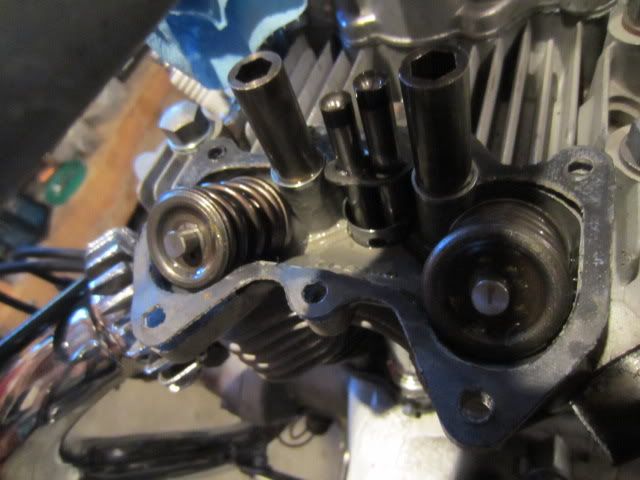

Completely rebuilt this 1971 T120 engine from the sludge trap up. Rebuilt head with new guides/cut valves..etc..etc.
Followed the Healey article in Vintage Bike to ensure the rings seated. Especially since i'm using Hastings rings with the chrome top ring.
Been riding it for about a month. The bike starts first kick, pulls hard and runs pretty good..which is surprising considering the oil in the left cylinder.
Right side (#1) is beauty. No oil getting past rings and plug is nice tan brown color.
#2, not so much. I am steadily getting oil in the cylinder which is leaving a wet/black plug. Thought maybe the rings just needed time to seat, but its only getting worse.
Here are a couple pictures of #2 cylinder ports.
There is a small puddle of what looks like oil/gas in front of the intake valve. Not good.
Exhaust is very black/sooty/oily.
Bike has great oil pressure, installed Morgo pump.
Compression in each cylinder is 148 PSI.
Running 20w50, MAP oil filter kit installed. Drained the sump and got the normal amount of about 150ml.
I re-torqued after the first heat cycle and again after longer rides. Adjusted valves with each re-torque.
Just been riding around town so not a ton of miles racked up.
Also used the larger washers under the inner head bolts to prevent loosening/indents in the head.
The guy that built the head ensures me that the guides were properly fitted in the head and the valves guides clearance is spot on.
I'm starting to think I must've installed the rings wrong? or for some reason the the rings didn't seat on this side.
But i'm looking for suggestions from folks that have seen this before. Any advice appreciated.

Looks to me like the inlet guide with the puddle of oil might be your problem ... not many ways that oil could get in there.
Could be that the inlet guide had some carbon on it when it was pushed out, and that scored the bore in the head. Otherwise it could be the guide does not have sufficient interference in the head ... either way, oil would seep past the guide.
There are various ways to repair the problem, but all require pulling off the head.
.. Gregg

Thanks for the info Gregg. If I've got 150 psi compression, does that rule out unseated or wrongly installed rings? Strange they would seat on one side and not the other.
I'm going to pull the head either this afternoon (if I can get some time in the garage) or tomorrow morning and take a closer look. Is a leaky guide something I'll need to also remove the springs to see? Any tell tale signs to look for on the head?

Thanks for the responses. As listed in the Healey article, I did run 30wt non detergent for a few weeks of riding around town- with 2 oil/filter changes in that span. I didn't pussy foot it either, good pulls through the rpm range, varying rpm, no idling. Then I switched to the 20w50 because that 30wt isn't good on long runs..doesn't maintain much viscosity when real hot. I also figured the rings were seated since the right side cylinder is running so clean.
Is there any way to tell whether i'm getting oil from the guides or from the rings?
Will a leakdown test tell me anything?
I was told I could fill the cylinder with air and use a bar/lever fork setup to get the springs off with the head on. I think i'm going to try this. Anybody trid using Loctite 567 under the guides with success?
thanks again

I'm with Gregg and Bob on this one....I had my guides replaced last year, but had the foresight to have the head soda blasted before they were extracted...this forum has saved my a$$ countlesss times...
I know Pete R has said that if the guide is still tight in the head, you can seal around the guide and lower spring collar with silicone sealant or Loctite 567.

It's hard to imagine that oil staying in the port during an intake stroke.The engine would have been idling when it was shut off.There would be high cylinder vacuum and fuel/air still flowing into the cylinder at the end of intake stroke.
I think that oil got there after the valve closed.Either leakage around the valve-guide OD,or the intake port has an extra hole connecting it to an oil reservoir.I can't see any extra holes that shouldn't be there,but it might be worth investigating the thickness between the flange threads and the rockerbox interior.
If the engine was shut down on the prop stand,1/2 the oil in the rockerbox would gravitate toward the primary side intake port.
Leakage around the valve-guide OD seems to pull in a lot more oil than a worn guide does.There must be more oil around the lower spring collar than there is on the valve stem.

Hey Pete, your idea to remove the spring with the head on worked like a charm. I poured some kerosene around the guide but not enough to reach the stem hole or pushrod tube, and it looks like it is seeping in around the guide slowly...probably faster when heated up.

Looks like you proved where the oil is coming from ... better around the guide than a casting flaw!
If you think you can re-install the valve spring with the same technique you used to remove it, I would degrease the head and lower spring seat very carefully, and then reassemble with high temp silicone sealant between the two.
Let it cure thoroughly, and I'll bet that will stop the oil leakage into the port ... and then you can have a chat with your man about the work he did on the head.

Ya know what, that may not be the problem after all. At first I was getting traces of leakage on the clean paper towel i was using to spot leakage. But now I'm getting nothing coming through and the guide seems like a real tight fit in the head.

I think this deserves a thorough test.Something unusual is happening somewhere.I'd even unscrew the port flange,to check for any leakage between the thread and the rocker box.
Seal off the pushrod tube,or dam up one side of the rocker box.Then flood the primary side spring seat and guide flange with kerosene.
Then just wait and see.Any leakage might be more noticable when the engine is running:the head would be hot,and there would be vacuum in the intake port.

Plus, how would the intake port get full of oil if its getting past the rings? The valve should either be closed, or air getting sucked into the cylinder...not forcing it out into the port.

I've had oil leaks in to the ports from the sleeved cylinder head bolt holes. The solution is to fit longer sleeves.
I've also broken into the valve spring well due to porting, the solution being either welding or plastic metal.

Why did you remove the picture of the intake port?
The 1971, and later, heads are prone to leakage of oil down the 4 inside head bolts (studs in your case). Tom Sharp, and others, have made up head washers that include a seal. This prevents oil from draining down the head bolt (stud).
It is not uncommon or these heads to be fitted with sleeves where the port has broken into the head stud area. There is always the possibility of oil leaking down the stud and past the sleeve into the port. Remove the left intake head nut and washer and flood the area with kerosene. I think Stein is on to something!

Exactly. While you may well have rings that have not yet seated, that would not explain that massive puddle of oil in the inlet port.
Hey John, I looked at an old T120 head I had on the shelf and it also had the headbolt sleeve coming through into the intake port, so I figured it was the norm. There was signs of oil on the headbolts, but after filling the headbolt hole with kerosene, there was no leakage there. I also left the guide submerged with kerosene over night and there was no leakage.
I would like to get my hands on some of those washers you mentioned with the oil seals though.
Dave thats interesting you mention the engine spitting back through the carb, the bike was doing that the odd time on the left side only. It only happened when kicking it to start and then ran fine after it fired up. I figured it was due to the plug being covered in oil. It may have been spitting oil back into the port each time...but wouldn't it just get sucked back into the cylinder once the engine fires? Man. I'm confused. lol
I did always put my finger over the return hole in the oil tank to force oil to the rockers on startup. Is there a chance I was flooding the rocker boxes with too much oil ?
I find it strange that the rings would bed in one cylinder and not the other, but to eliminate the possibility of this being a problem, I'll order up some hastings cast iron rings and get ready to start this process over again in the spring.
Hi Dracko,
I would think yes it would. If the picture is of the time just after you did that, maybe yes.
You did mention that you replaced the too small washers with larger ones, and that is why I did not mention what John did. But you did not say whether or not there were depressions in the head from the too small ones. So perhaps you did not catch the problem. There could also be a small hair line crack which opens up more with heat and vibration.
So, other things to take into consideration to diagnose the problem. Did it smoke out the exhaust pipes? On Acceleration or deceleration? Smoke only for awhile after start up, ) indicates the head bolt problem), or even after long warm up?
Also I do not see you mentioning what brand of 20/40 weight oil. Castrol GTX will find it way into cylinder no matter what. I expect most auto oils will do the same, rated what SL SM? Too modern. Too many anti wear additives. They are meant for modern autos with very tight tolerances. Not our bikes.

Chrome ring seems good but, I remember Ricardo saying that a special additive is needed to get them to seat, in a reasonable time. He never mentioned what the additive was
Hey btour. I'm on the fence about pulling the head and jugs off and taking it in for rebore/new cast iron rings...or trying to work this out and ride it for the remaining month of summer. Where could I get more info on this additive?
After running non detergent 30wt for a few weeks, I switched to 20w50 motorcycle oil. It was Suzuki brand, non synthetic. I don't know the rating but I can check. I figured the effects of running 30wt oil had already taken place and it would be alright to switch to something better for the engine.
I pulled the 2 headbolts on the left side and there are no indentations under them, but they did each have a coat of oil on them.
I may try sticking some viton orings under the washer if I bevel the inner edge of the washers...like mentioned in a thread on this site. Would it be dumb to just lay a thin bead of hondabond around the bolts and install them? Don't really see that silicone getting out of there from under the washer.
It smoked on start up for a while, but prior to pulling the rockers it was smoking for longer...all that oil in the intake port probably.

I pulled the 2 headbolts on the left side and there are no indentations under them, but they did each have a coat of oil on them. .... It smoked on start up for a while, but prior to pulling the rockers it was smoking for longer...all that oil in the intake port probably.
Sounds like the inner head bolt situation is part of the problem. It may also be valve guide, and your flooding of the rocker boxes. All contributing a bit.
About the head bolt problem: According to Jaye Strait, in his experience, some bikes leak, and some do not. He has not figured out what makes the difference yet. I certainly do not know. Speculation: Perhaps it is how square the bolts holes are tapped to the cylinder and head? Something like that making a slight difference from one to other in the manufacturing.
Jaye says, sometimes the oil finds it way to the outside and sometimes the inside. Sometimes both.
