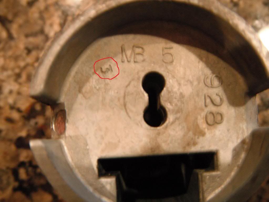

Pull the carb apart and was surprised at what I found.
1. Throttle slide is marked MB 5 and 928
2. Needle jet is as expected, a 106
3. Main jet is a 170, which surprised me. I do still have the original 190's.
4. The plugs are Champion N4C's so it looks like I tried going hotter at some time in the past as the Handbook says N3's. I have some NGK B7ES plugs as suggested above.

quote=geryrace] 1. Throttle slide is marked MB 5 and 928[/quote]
That is not the number you want. There is another number on it. If not, then put the slide on a flat surface and measure the distance to the top of the cutaway. The number that should be there, would reflect how many 1/16 ths.

Plan completed as described above. Took her for a 7 mile spin up a foothill with top speed about 50 mph then pulled clutch in and killed it coasting to a stop and pulled plugs. They looked good. Not white nor sooty. Did I do it right?
Question: I have minimal (less than a 360 degrees) of air screw adjustment on left carb before it revved or died off whereas I had nearly twice that on the right. Is that common or indicative of another issue?
Question: It doesn't feel as peppy as it should and as I remember my '73 being. Best plan is to get the 105 needle jet assembly and play with the 170 and 190 mains that I have to see what I get?
Question: Saw no other numbers on the slide. Location?
If I measure the cutout in sixteenths, then what do I do with the number?

Difference in air screw adjustment could indicate a partially blocked idle jet.
Did you look for slide numbers on the bottom of the slide, the part that sits in the seat?
gery...you gotta look closely. There should be a small-font number nearby as shown in the photo:
HTH,

Thanks for the pix Steve, but you call that a number! I couldn't discern the one on my slide much less the one in the pix. I'll measure and look again when I get the the 105's. Moving methodically as John suggested

Morn'n Geryrace,tip your head 90 degress to the right and the number starts to make sense. The viton needle that was mentioned is for the float.It takes the place of the plastic needle. Dick
