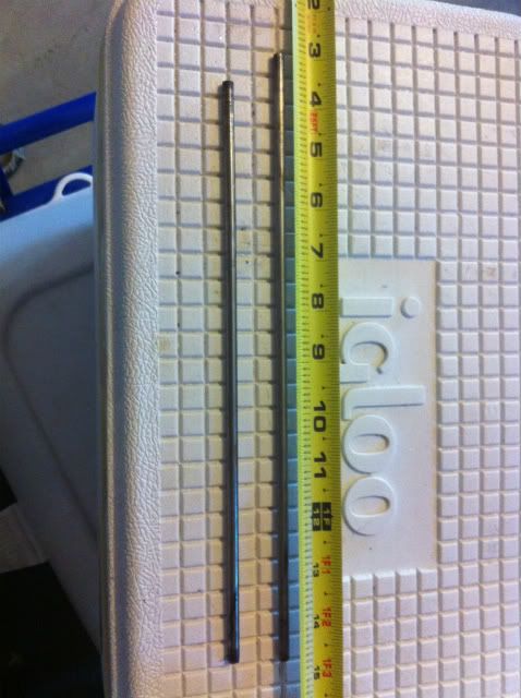

Anybody know what the length of the clutch push rod in a 1969 A65 should be? My clutch was at the limits of its adjustment at both the lever and the pressure plate so I have replaced the cable, clutch plates and the push rod which looked worn. The existing rod is 11" long and the replacement is 11-13/16". While the old rod appears to be too short the new rod appears to be too long.
Should I grind the new one down to the correct length? Suggestions?

Jim, the service manual says the clutch operating rod is 11 1/16" in length and 7/32" in diameter.
Jim [/quote]
yes - but do it slightly larger than old one (in increments is best to get proper/good length)- grind/lengthen and assemble and see if it works proper - if not reduce a bit more
also good to heat treat the end after grinding to best length to prolong its life (heat up hot and dip in water)

I think it is very important to do the heat treatment.
Plus check to make sure the diameter is exactly the same as the old one. Sometimes people supply near metric equivants and they can bind, overheat and seize.

Heat to red hot and cool in oil.

I have measured push rods as well as clutch rods before and they vary. Cannot imagine the quality control problems BSA had in those days as these are incredibly simple things to control. If the push rod is too short the grub screw can't take up the slack, and if it is too long it sticks out too far and hits the cover. If your plates are fairly new (full thickness) check by trial and error to get it right.

Quench in water!
As per SRM instructions when shortening the push-rod when fitting the Alloy clutch plate!

Quench in water!
And the ASTM Handbook says to quench is oil.
Water quenching small diameter rods is too severe and can lead to cracking.
Whichever medium you use it is even more important to swish the rod around to prevent gas bubbles sicking to the surface and creating unevenness i the hardless.

If it silver steel you can use either water or oil depending on how hard you want to get the ends.
I used water quench when making things like production drill bushs which needed to be like bearing hard.
But for things where brittleness is an issue (like the push rod) I would definatley go with oil quench. The thing that makes the biggest diffrence to hardening silver steel is how hot you get it and how long you hold it at that heat for. Discussing quenching media is pretty pointless without a material spec , exact temprature of heating and lenght of "soak"

Thanks guys. The existing pushrod was mushroomed at one end and an additional ballbearing had been added on the lever side to try and make up for the wear. It was now at the point where even at the full limits of the cable and pressure plate adjustments it would creep in gear when hot. The SRM description for customizing is helpful. The diameter of the new rod seems fine. Will let you know how I make out.
