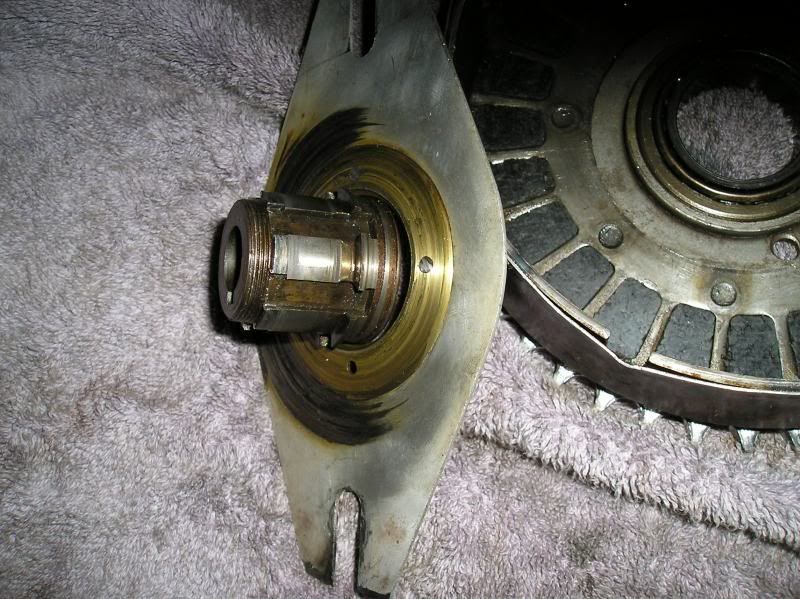

well I got my clutch puller a month ago, but only today finally got the time to work on 'er.
I think I found the problem, but it doesn't give me a cause. the hub seems to be wearing into the brass seal on the floating plate. is there an adjustment side to side on the transmission?
it's worn thru on both pieces, the hub is somehow pulled too tight into the transmission. the way it sits now the oil grooves are pulled all the way thru the seal. this is probably why it's leaking so badly, not to mention how worn the brass is around the whole hub in the first place.
the basket is also loose on it's bearings, not bad perpendicular to the shaft, but lots of wobble
have we identified a replacement sealed bearing for this like the wheels? can this be replaced?

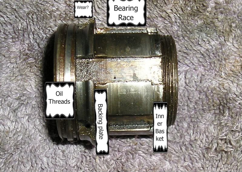

not sure I follow? my problem isn't the chain lining up as much as it is that the assembly that holds the inner bearing race, basket, and inner clutch basket is pulling too far into the brass seal on the plate inside of the primary cover, due to being too far up the tapered shaft of the tranny.
so I've annotated this pic. I am calling this the hub, is that correct? so the area labeled "wear?" seems to be pulled too far into the transmission, up on the taper of the shaft. the oil threads stick out the seal, and the flanges have worn into the seal quite far.
here is the hub in the seal as it sits on the machine
the oil threads are sticking out the backside of this plate, where they should be just inside of the brass ring, and the flanges should be well out of the brass?
I'm not sure why this changed, when I first got her running I didn't notice the noise when I pulled in the clutch, but now I've been hearing it rub when stopped, with the clutch pulled in. I could tell it was rubbing somewhere, but just couldn't tell where.
so my immediate problem seems to be either that the clutch hub is pulled too tight up the tapered shaft, or that my tranny is shifted to the right side of the bike somehow?

Been following the thread with great interest, It does seem that the primary chaincase is to blame here. Ensure that its not warped at all and is fitted snug to the frame as Bob mentions. I doubt very much that the transmision box as moved at all, its usually a tight fit so that primary chain cannot slacken.
You mention difficulties with the clutch bearings, These need to be in the correct way round and should fit snug into the clutch drum, there is a much discussed thread about these six spring bearings on another forum. Alternative bearings are available in the UK and are obtained from... Draganfly
Hope this helps! smile

Hi LJ, thanks for the info, that set looks very nice!
looking at the De Groots page, http://www.degroot-bsa.nl/index.php/cPath/75_93
I see that my clutch sleeve isn't all that worn down, but also that the "oil threads" as I have been calling them, are a collar that is replaceable!
[img] www.degroot-bsa.nl/popup_image.php/pID/1017 [/img]
is this what is referred to as the chain oiler? I thought the threads would keep the oil in, but...
so many thoughts, and parts are available, but I don't really want to buy each part that's a little worn.
any thoughts on buying new balls that are ever so slightly larger than the current ones to take up the slack from the race being worn down?

Snow...
The oil threads as you call them, I believe they are there to 'encourage' the oil back into the primary case and possibly for the oil to work it's way into and around the bearings. (Correct me if I'm wrong someone!) It is deffinitly NOT a chain oiler, the chain is more than adequatly lublicated by just touching the correct oil level. I think the oil falls into those threads and at speed it is transported away from the gap to the outside world.
During running if the oil is at its correct level then there would be quite an oily splash/mist flown around the case and running down onto that adapter thing on the end of the mainshaft. It need not be replaced, also it is normal for the bearing race to be sloppy, again not needing to be replaced, its also unlikely that the balls are worn down. Really then, It's all basically a matter of putting it all back together correctly.

you're right of course, I had already looked at them and the direction of rotation should have brought oil back into the case. I do a lot of this posting from work so I only have my shoddy memory and any pics I can post the night before to go by wink
the chain oiler I meant was the final drive chain, but it's not that either.
I'll have to check the case mounting, that might be my whole problem and then I can just reassemble. wouldn't that be grand!
Thanks again!

well I'll be danged, Bob hit it!! no spacer on the frame mount at all! that's why the bottom was pulled out further and rubbing!
so now my question is does anyone know offhand what length it is supposed to be? I'll probably just use a few washers to space it out, but it would be helpful to know what size I'm actually shooting for.
