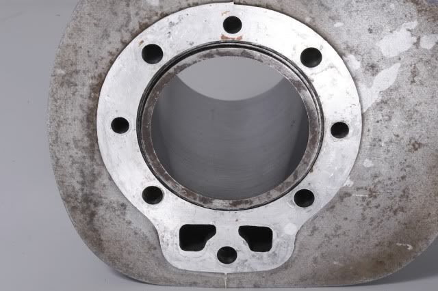

I need to hone my cylinder to match my new .040" piston and rings. My manual suggests a clearance of .004-.006" at the bottom of the skirt. Is this correct?
I am open to any sage advice and voices of experience on clearances and grit of the final hone. I need to know what to tell my machinist.

4 to 6 tenths of a thou may be a little tight(typo perhaps) 4-6 thou probably a bit more reasonable

I've not fitted a Weisco in a GS, but have been fitting custom designed Venolia pistons by Ron H. at GSR for several years. I/we fit the modern forged pistons at 3 to 4 thou clearance in the Goldies with no problems. A final hone finnish of 350 - 400 grit seems to work fine with modern nodular iron rings. I sure hope your machine shop uses a precision hone vs the POS tools some use that will give you a out of round bore with a belly. aarrgh.
Speaking of bores ... I'd heard of Bore Tech for many years but not used them until recently. The 'carbide coated' bore job they did for me on a 90 bore GS cylinder was nearly perfect. Measured with my electronic bore gauge the max error was less than 2 tenths!
If you'll notice a 'modern' piston is uses a short wrist pin and the wrist pin bosses are well inside the skirt. This reduces the skirt distortion due to the heat absorbed in the heavier wrist pin boss section. Because of this design and the high content of silicon in the alloys, the modern forged piston have much the same expansion rate as the olde cast pistons.

I used a Phil P. Weisco piston some years back and I used .0045" and all is well so far....
Now here is a bit of info that you may want to look into. Those "skinny" rings have a number on the box, something like 33485 (I'm not near the garage to give you the exact number) But after talking to Phil, It appears that this an english number when the rings are perfect round. Meaning: 33485 = 3.3485"
Now you need to do a balancing act on rings being perfect round and piston clearance. Also note those rings are really, really hard. I was lucky that at .0045" I was only .0001" from perfect round of the rings...
Yours and others piston/rings may not be the same as mine, but something to think about.
