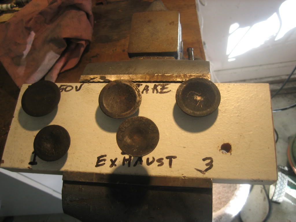

A bit more attention today, I'm off on a trip tomorrow and wanted to do a couple of tasks.
Here is how I like to arrange bits, the lifters are a push fit in the board and the outside nuts and washers screwed down. I have what the bike is, the serial number, and where the head and one valve are. You never know who might be finishing your bike...
Re: A California TR150V [Re: Cookie] #333425
09/14/10 2:36 am
09/14/10 2:36 am
Posts: 3,775
Posts: 3,775
I use a very similar system to make sure the cam followers go back in the same place they came from. Do you post on triples on line as cookiecook? I had to laugh when I saw that because my last name is Cook and my close friends call me Cookie

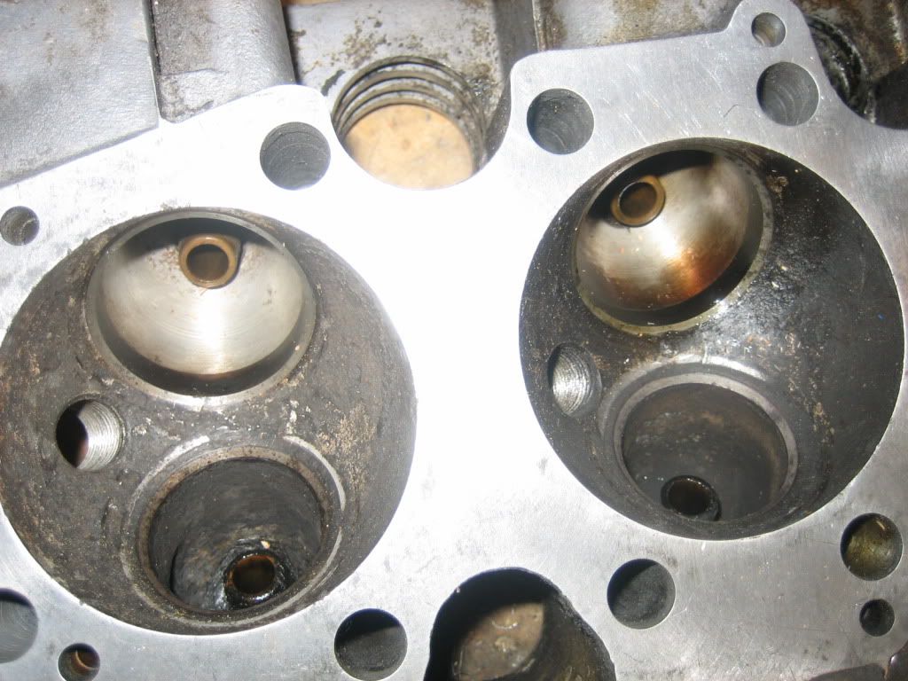

The far thinking engineers at Triumph cleverly designed the triple head to fit easily in a saddlebag for transport. My friend North not only found a reamer but reamed the guides to size and vapor blasted the head for me!
Tonight's goal was to clean the remaining valves with the aid of my tiny brass wire brush on my high tech 1/4 inch drill.
