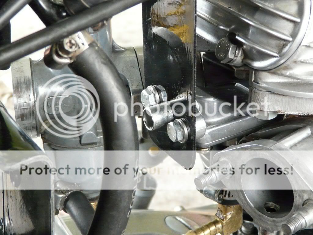

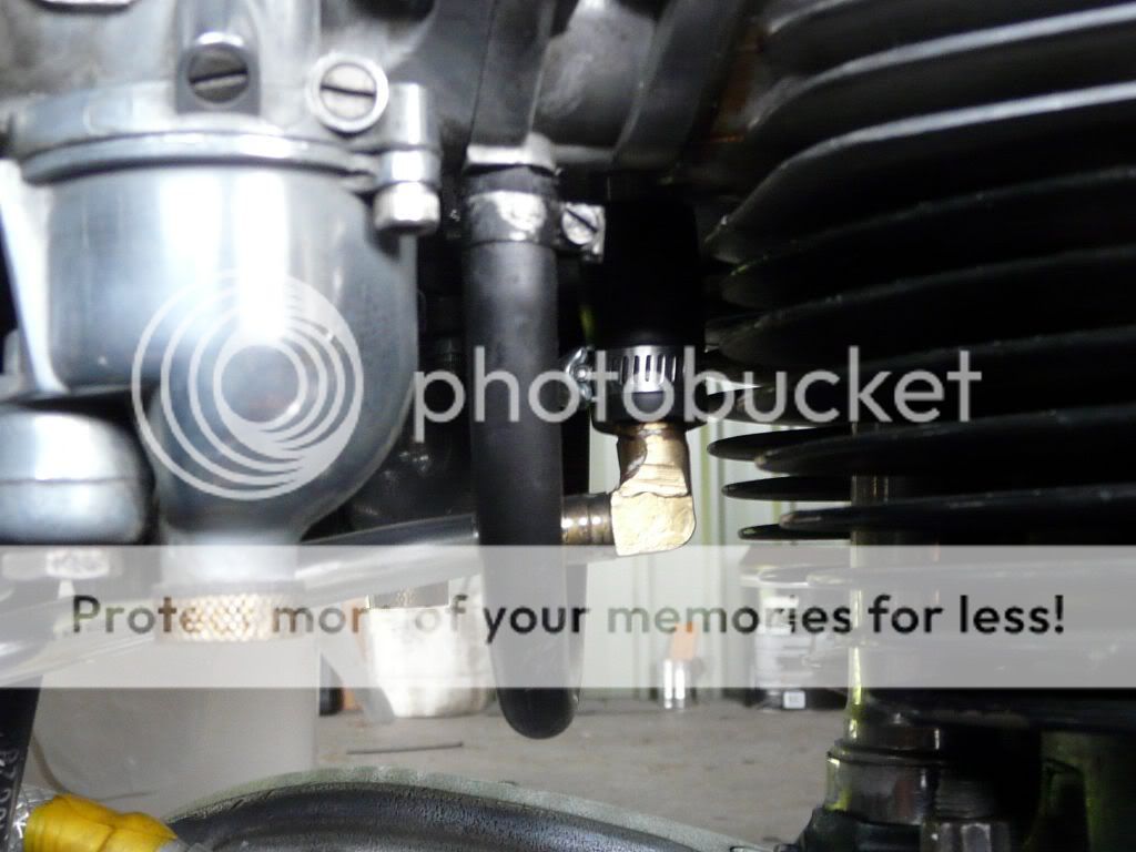

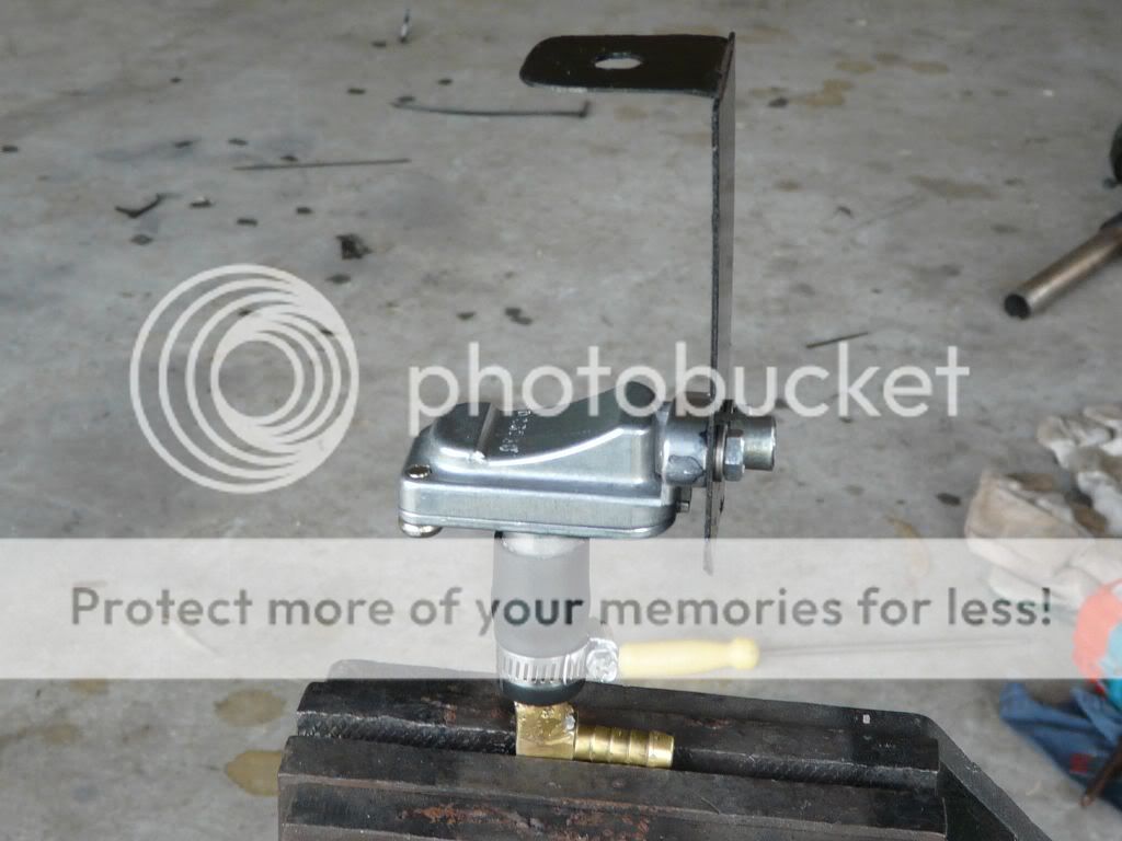

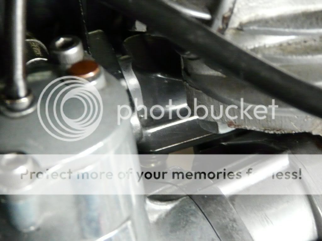

Now then Laddie this is your lucky day, a warm breeze up you kilt kinda day.
Let's start with a look at the Yamaha XS650 reed valve and a mounting bracket I fashioned for it:
[img:center][/img]
This is designed to hang from the same mount that retains the head steady brace. Mounted with inlet facing out, it sits ever so snugly in the head recess between the twin carbies. A TR6 mounting will no doubt require a different placement. It makes no difference how far the valve itself is placed from the crankcase:
[img:center][/img]
You will need to fashion your own adaptor to suit your personal plumbing preferences. The fitting on the valve is 3/8". You'll see I used brass and made up an elbow reducer 3/8" to 5/16".
Here we see a view of the valve itself tucked away behind the installed carbies. This is so neat, old RF himself would miss this on an concourse inspection of the bike:
[img:center][/img]
[img:center][/img]
Please ignore the clear plastic tubing in the photo, this is an inappropriate tubing for this application
