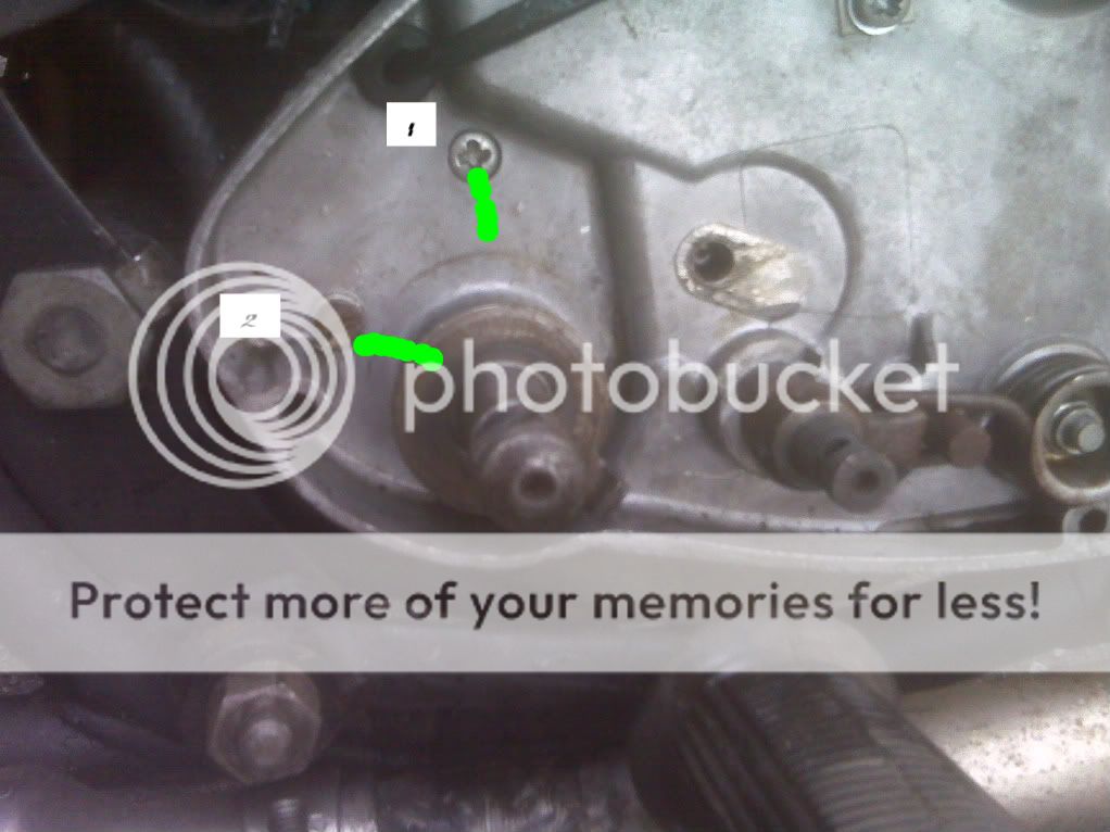

I finally got my new kick start spring in the mail, but the old one was completely broken and out of place when I opened the case up. I figured I could figure how to place the spring, but no luck. Can anyone shed some light, or have picture of how they look installed? Couldnt find any directions in the workshop, haynes, or parts manual.
Thanks!!!

Well,
all I can say for certain, is that in the 'bucket photo, you're holding the spring up backwards, which will pull the kicker down, not up.
It's been MANY years since I put one in an A65...
The washer with the tang might be installed incorrectly, and may need to be reversed...
Oh yeah, it can be dangerous.
Do wear some good gloves.
If the spring slips, it may cut your hand.
That outer 'loop' goes under that slot headed screw? You see how the loop is on the "outside" of the coil? I think that was to avoid striking/binding on the case screw tunnel....
That's about the best I can do...

Which screw does the other loop go to, the one directly above the kick start or the one up and to the left?

I just happen to have one of these staring at me from the shelf . I cant post pics from the lil' notebook thingie I am on but i will describe .basically you have to install the spring and the retaining plate .You need to remove your retainer and install the spring with the flat hook attached to the slothead post leaving the other hook standing up. the retainer has that hook that slots into the spring hook. Here's the part that really really sucks, all ya gotta do is wind the spring to put tension on it , fit it on the lever shaft without the spring jumping off .this is where a heavy glove will save you some skin on the palm of your hand .what i like to do is install this with the inner timing cover removed , then I weld the retainer to the shaft with a tack and grind the excess then I simply wind the thing up before I install the cover .

This can take 1 minute..................or all day. File off any rough edges and burrs so the plate will slide on nice. Don't be distressed if its a b*tch, thats often the case.

I hook it on the screw and hassle it around with long nose vice grips. the hose clamp helps keep the spring retaining plate in place during the ordeal.

It dosent look like you have tha right spring.

Kelvin is right you dont have the right spring (going by the photo in your link) The spring Bob shows is the right one,
It is a pig of an act but sometimes it goes ok....other times ...well ya know.
It hooks over peg 2 in your pic.
The only real helpfull comment i can come up with , other than wear leather gloves, is to bind the coils together in 3 places with some light steel wire (1.6 or so) and twist the wire up tight. Just go round the coils once and then twist off or it will be hard to get the wire off after.
Doing that stops the coils flapping about all over the place while you are struggling to get the tensioned keeper plate over its slot.....if you can get a freind with a hammer and a peice of steel tube have him stand by to give the keeper plate a thump (tap realy) when you are struggling and swearing and almost have it on....when you have it on get the outer cover on real fast and resist the temptation to try the kick start just to see it working. (dont forget to remove the temp wires)....try it without wiring it 1st if you want but just remeber about it after 2 hours if it doesnt go well.
I just hold the tang on the retainer with some vice grips ....rough as **** but a mans gota do what a mans gota do.

darn, this spring is indeed wrong, its backwords.
Atleast I understand how it goes in now!

And - the tang on the plate is to point outwards.

Allan - I've allways put the tang outwards, like the factory said, and never had any problems.

Allan - I have seen aftermarket spring plates that has too long tabs, which grind into the outer cover. This can be corrected with a file. My A65 is a -70.

I've had similar results, I prefer to set the tab inward ,makes sense to me , ut I have taken the cover off and found several of them working fine with the tab outward . I didn't disturb them if it wasn't necessary.

Tab goes outwards.
I use a loop of wire over the tang to pull the spring closed.
The wire is pulled/held by a pair of locking pliers.
And wear gloves smile

Similar to Bob....Hose clamp to stop the spring flying off, hook it around the screw on the timing cover first and then I use a puller that the motorcross guys use to fit exhaust springs and just pull it round and hook it onto the tang on the washer...dead easy.

My $.02: I've replaced my kickstart spring a number of times over the years, and tried various methods and tools, at last arriving on what I found to be the simplest and quickest method, employing only a pair of heavy suede welding gloves.
That's right; don the gloves, hook the spring, grab the plate, twist and push. The sharp end of the spring will not penetrate the gloves.

Thick friggin gloves, LOL! that washer is how I get those on. I grab the extended bent spring tab with 7R's and pray I get the flats right 1st try. In 2 weeks or so there will be an A65 here for this whole ordeal after being ridden since I last saw it and bodged it a bit which has lasted.
-That spring of Bob's would be happier in my b44 I think. Maybe you can grind back the tail to get a good seat. Not seen the end loop bend only break.
