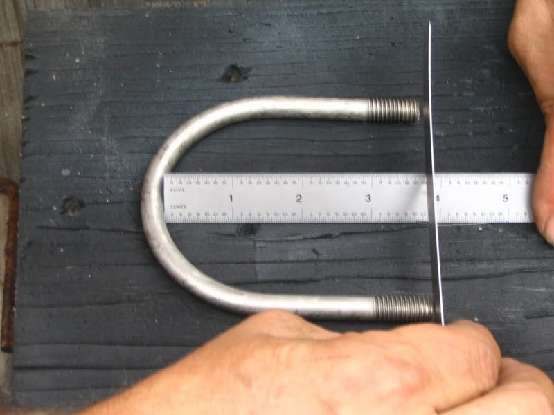

Alex don't cant.
S.S. three inch exhaust clamp shortened like so.
