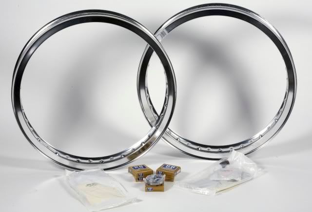

After much consideration, advice, research and thought, I went with 19" Excel WM2 and WM3 front and rear. I can run either modern style Avons or original Speedmasters. Each rim weighs less than 5 lbs and they are beautiful. Sealed bearings are 1640-2RS (7/8" bore, OD 2" and width 9/16") to replace the open caged style in front and rear hubs. I invested in a really nice truing stand and cannot wait to lace and true these wheels, but need to decide how I want treat the front 190mm drum. Original Hammerite paint, polish or powdercoat?
