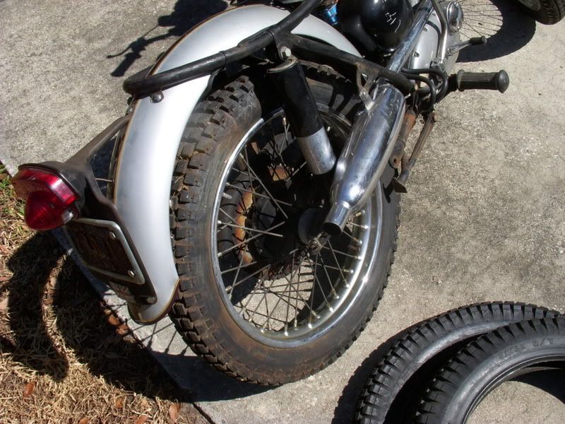

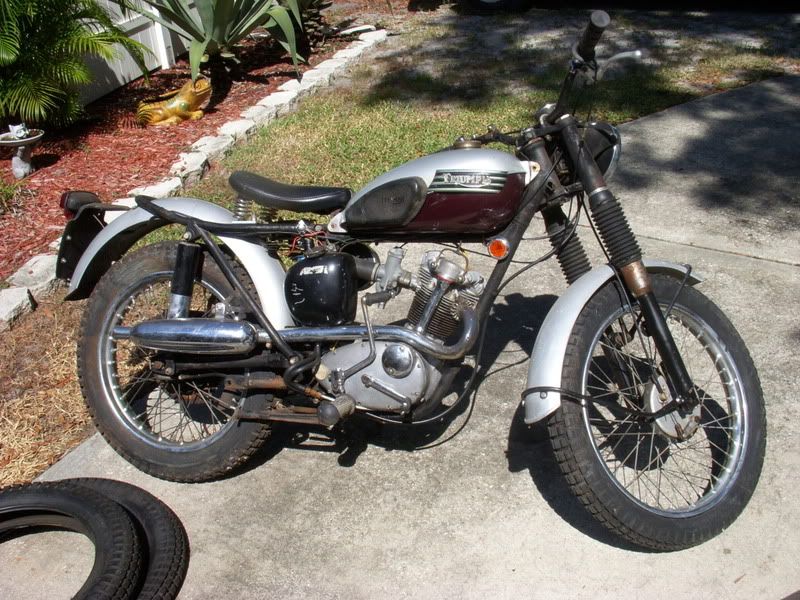

I bought a 65 Mountain Cub on eBay. The PO said that the engine had been rebuilt. eek It runs good with no smoke or blowby. I got two new tires and a box load of parts to go with it.
tired The clutch wouldn’t release which I traced to an unwound spring in the clutch. My wife fell in love with it so we did the 4 hour cleanup and a box of SOS pads later, here is what we found.
There is a spot of light rust pitting on the rear rim about the size of a dime and one on the front rim about half that size. So now I have a Cub resto project that has vaulted to the top of my resto list. I’ve done many a motorcycle in my time but never a Cub.
The questions:
1. It is titled as a 1965 but the VIN says: T20SM692 That suggests that Cubbie is a 1966 (so do the frame and engine). I understand that the Cubs changed significantly from 65 to 66 and I want to buy the right parts.
2. The rear fender is not alloy but the tank and fender paint matches perfect and both are shiny and unmarred originals. The front fender is alloy and nearly perfect. Isn’t the Mountain Cub supposed to have an alloy rear fender?

I don't have the numbers readily available, but SM would indicate 64/65, in 66/67 the ID changed to T20M. And, your taillight is a one year only for 65.
I think the fenders were alloy for 64/65, and stock color tank for 65 would have been Hunter Yellow (64 blue and silver, 66 "orange" and white), so I question the tank and fender being unmarred originals. Your colors are stock Cub colors, but not Mountain Cub.
If you are going for correct, I'm pretty sure the aircleaner is wrong... in 66 it was a Volkes D-shaped can, I think earlier was a set-up unique to the Cub... but they may have had the Volkes in 65?
Also, it would have come stock with ET ignition. Though yours would be considered an improvement by most folks.
The under tank reflectors wouldn't have come on it.
But a neat little bike, should be a pretty simple restoration. Have fun!

Thanks. The numbers I have say that 65 was T20XX 97XXX on and the 66 are t20XX 101 on. So the 692 would indicate 66 unless they ran out of numbers late 65 and started over then. The 66 parts book calls out a T20SM (wish I had a 65). The bike is so original in that the little parts are all there, correct nuts and bolts etc. I'm sure the tank and fender is a matched set but I don't think they came with this bike but they are too good to change.

Look at the date stamp on the Monobloc... if it is original, it will have been made probably about a month before the bike's production.
Your bike is a round barrel... square barrel started in 66. However, I don't know if the square barrel, and the T20M designation started at the beginning of the model year, there possibly was a run of SM/round barrel models early in the 66 model year?
BTW, I checked my parts book, your aircleaner is correct for a SM.
There was never a parts book made for the 66/67 T20M Mountain Cubs , don't know why... the last parts book calls out T20SM beginning with 101, and doesn't show the T20M parts. Even shows the round barrel.
