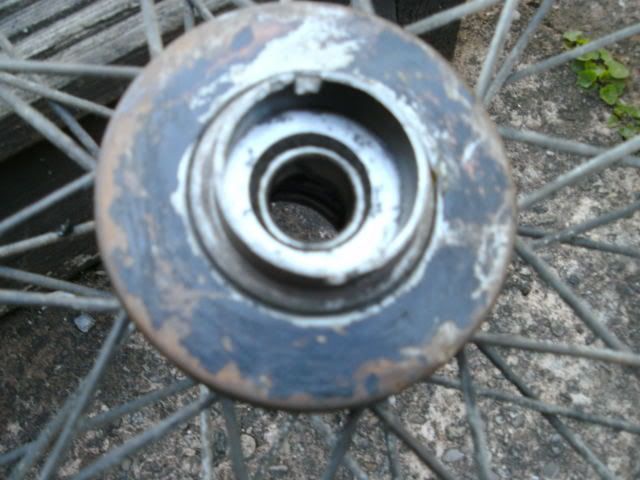

Apologies if this has been asked before, but how do I remove the bearing behind the 'speedo gearbox drive dog' the manual says is just drives out, I know I'm doing/not doing someting right here.
Does the grear drive un-screw (left or right)? then renmove the 'dust cover' or do I just smack it a bit harder?
The sprocket side was no problem.

Yup, the speedo drive unscrews. It is a left-hand thread.

You star, all done, many thanks!

Hello
It could have a left or right hand thread.... It should be stamped on the part that engages with the speedo dogs. I know mine was opposite to what everyone expected. Underneath it there could be one or two steel washers and a felt seal. Mine had two but when assembled it would lock up the speedo drive. I removed the outer and reassembled and it was fine. The extra washer made the spacer in behind loose axially so that the speedo drive outer couldn't clamp up against it. I have a 1966 & 67 parts book, the 66 has one spacer, the 67 shows two.
