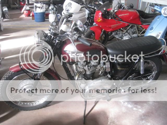

I am looking at acquiring a 1969 Triumph Bonneville T120R and I need some help with a couple of questions. Because the bike is titled currently as a 1970, and all indications are it is a 1969, I want to get the title corrected. I have confirmed it doesn't have the removable front engine bracket that was used in 1970. The VIN DC16072T120R from I have been able to determine indicates the bike was produced in April 1969. The bike has a rear grab rail that appears to be what was installed on the 1970's Bonneville and the paint color is maroon or burgandy and silver which is in the 1970 runs from what I can determine. I had a 1969 Bonnevillle back in the day and this bike is a twin sister...Does anyone know if Triumph might have installed a grab rail from the next years run based on when this particular bike was built? Same goes for the color...Any information would be greatly appreciated.
[IMG]http://i1012.photobucket.com/albums/af246/Bob80220
/1966%20Bonneville/1969TriumphBonnevilleT120003.jpg[/IMG]

I thought the 70 (69 as well?) rear mudguard support was black with a chrome grab rail riveted on, looks like you have the OIF rear rail which was all chrome or someone has had the orginal chomed. I have a pic of a 69 with the black support rail with the chrome grab rail so it may be factory fitted.

I have seen pictures of 1969 Bonnevilles with the grab rail as you describe with the black support rail. This appears to be a factory install. I was hoping someone here could confirm the build date from the VIN or direct me to a VIN decoder reference. From what I have googled, the information is telling me this T120R had a build date of April 1969. As I referenced earlier it for sure does not have the removable front engine bracket which from what I was told is an indication of a 1970 model year...

The 70 US 650s had the black/chrome rail early in the model year, but later the same year changed to the all chrome as shown... with no reflector, though the hole is there.
Though this bike has 70 items on it, by the 1969 number, and especially by the engine mount set-up, I'd guess it is pretty definitely 69. The front mount would be difficult to alter cleanly, everything else just kinda bolts on interchangeably.
Do the frame and engine numbers match?

Yes...it is a numbers matching bike...I confirmed that with my own eyes. There is no mention that this bike had changes done by the previous 2 owners to install 1970 items like the grab rail and the bike has not been repainted. Other than mechanical maintenance this T120R is original with 4K miles...

That DOES become a puzzler then. Lemme see... a 70 chainguard would not have the inside "flap" that the previous years had. A later 70 would have black face gauges. Different breather and hose-exit system for 70. Fender stays were chromed for 70.
There should be a build date stamped on the rotor, if you can go so far as to get access.

I showed pictures to another gent and he said the breather hose is not a 1970 set up. This is why I am posting for some insight because all indications are this T120R is definately a 1969 but has a couple of 1970 production items...that is why I was curious if perhaps Triumph built some bikes in late 1969 and installed 1970 parts or paint??? I appreciate you saying this is a "puzzler."

Little hard to tell from the picture, but it looks like the seat cover is from a 1967-68 (pleated but with no perforations). Actually it looks like one of the seats we assemble here (seat trim is one give away).
The "text book" 1969 model had the chrome grab rail mounted to the under side of the seat by four 1/4 UNF bolts. If the hand rail was used to put the bike on the center stand, it broke the back of the seat in few attempts. The rear fender bracket was black and had no provisions for a hand rail.
The horn is typical for the 1969 model.
The handle bars are more like the ones used in 1973.
The engine is earlier than 1970 as there is no breather on the back of the primary. As indicated by the motor number it would be a 1969 year model. This would also not be an interim model that might of had 1970 paint scheme as the switch over would have come in late August early September for the next season.
The bike is missing the front yellow reflectors and brackets that mounted to the front gas tank bracket. It also looks to have Taiwan air cleaners with paper filter elements. If it was a 1970 they would have "dished" backs. The original were gauze. The breather seems to be exiting above the right rear shock. It should have extended back to the end of the rear fender. The front fender brackets would have been chrome for 1969 and 1970, not black as shown.
On the face of it this appears to be a very nice motorcycle, but IMHO is a bitsa and it is not an original 1969 Bonneville! Someone like the 1970 pains scheme.
There are too few good pictures of the US Spec 1969 Bonneville. Although a real important bike, Gaylin rambles on in his Triumph restoration book about the 1969 supplying absolutely no pictures. The 1969 US sales brochure is of little help having been blurred by artistic light bursts. But it clearly illustrates the points I made above: chrome front fender braces, yellow safety reflectors, etc.
There are other details that make me believe the bike has been worked on

I notice the bike has black front fender stays. 1969 and 1970 Bonnies sold in the USA had chrome stays.
I suspect someone (maybe a dealer?) switched fenders, tank and
passenger hand grip to make the bike look like a 1970 model.
Also, the photos show the mounts for the clutch and front brake levers are 1963-69.
The 1970 models had mounting holes for mirrors and 1970 was the only year where that type of mount was used
(1971-on used entirely different lever arrangements.)
As Triumph's model year production would end late in July, and your serial number indicates this bike was built in April,
I find it difficult to believe Triumph would be using 1970 parts on a '69 bike as early as April.

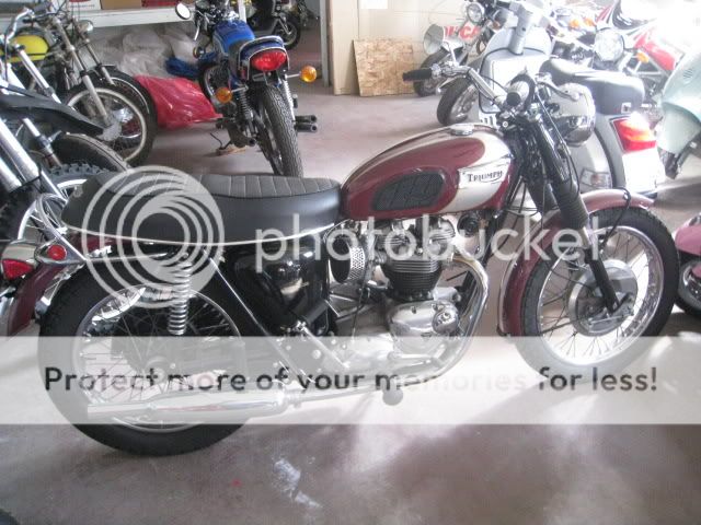

Kenny Dreer's bike has two lugs on the lower front fender bracket where the the guard fixes to the bracket, '69 bikes had one.
Two is better but not original.
If you go to Atlanta Bonnie's link and click pictures of the '69 Tiger one photo shows chromed front fender brackets and the other photo black painted brackets [which were "home market" I think].
All this is done for the gratification of Anoraks I reckon.
The grab rail bolted to the seat pan on the '69 was apparently a lash up to comply with newly introduced US legislation, does your seat pan have the grab rail mounting holes ?
Sure is a nice bike, maybe a dealer did make some small mods to "update" the bike back in '70 ?

The USA Bonnevilles made later in the 1969 production run had a lower front fender stay with two lugs on it. Allan

Just to drive Mike crazy, back to the grab rail... now that I look closer, I do see that it is a 2 piece rail... the late 70 was just one piece. Good eye John, it is a later rail.
In the US, getting a DMV clerk to accept the dating authority of a private, overseas motorcycle club (visions of Lee Marvin here), regardless of the source of their records, might be a most difficult chore.
Here in California, I have never had a problem with verifying and even changing the titled date by bringing in literature supporting my claim (Gaylin and Brooks or Bacon books, for example). Additionally, the Highway Patrol Code Enforcement officers have very complete books verifying VIN dates for motorcycles at all their stations. But that is California, there are 49 other sets of rules to contend with.

Well it appears my inquiry has unfortunately created some significent differences in opinions...for that I am sorry. I have spoken directly to a few sources that were in the Triumph business back then and they all brought up an interesting point. It wasn't unusual for them to take a tank and fenders from one bike and put them on another becuse the customer liked that color better than what was originally on that bike. I wonder if that might be the case with this particular 1969 T120R as the VIN numbers confirm it's a 1969 but the color for sure isn't. From what I am seeing and hearing it is a 1970 color scheme. As for the rear grab rail it appears to be a 1970 as well from what I see in pictures of 1970 Bonnevilles...of course I certainly could be mistaken. That being said this particular bike would not be an "original 1969" because of those changes...but it is a 1969 T120R none the less even though it has 1970 model year color, etc. My purpose is to acquire a nice classic Triumph to ride. I'm not looking to put it in a museum, have it featured in a magazine or book, or haul it to an auction with the hopes of making a profit. This is a very nice numbers matching 1969 T120R...that for me is the most important issue. I have seen a number of bikes from this era repainted to what the owner desires and this was a very common occurance. I want to thank everyone for their input as it provided me the opportunity to gather more information and knowledge than I had when I first posted. I have no idea, but I will ask, if the original owner is still around. Perhaps he purchased this 1969 T120R in 1970 and when he saw a 1970 on the dealers floor he asked him to make these changes...then maybe he decided to title it as a 1970 even though the VIN is a 1969. Sounds plausible to me. If I am able to back track and get more information I will update the board. Again, thanks all for your insight and direction...
