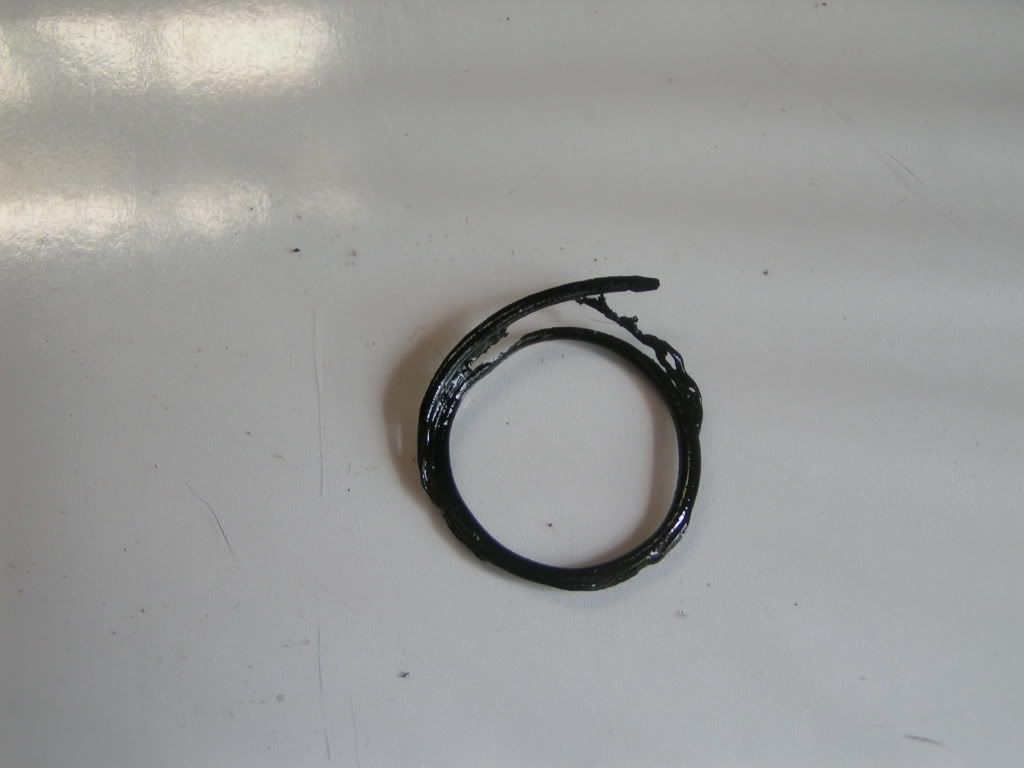

Here's the tappet block o-ring. I know it's not an installation issue, as I "installed, torqued, and removed, and inspected" several times previously on the last build.

I don't know this with any certainty but I think that you need to use the OEM o-ring. That o-ring appears to have been heat damaged and I seem to remember reading somewhere that the OEM seal is made from some kind of high temp material.

It does appear to have a charred, cooked look to it. I may have missed something re: type o-ring being used. Is this an "equivalent" part which may only meet size but not spec for the heat realm?

Locktite just makes it uglier, trust me, and hard to get clean. The only fix is the correct o-ring. On it's way with other gaskets from M.A.P.

I think a picture of the tappet block with the O-ring on it is in order. It looks like the wrong size O-ring to me. Jack

Actually, the o-ring matched up identically diameter and thickness wise, this particular (and apparently the previous 4) did not have the heat resistant characteristics required...So DON'T use the o-rings supplied in the EMGO kits...Always special order these o-rings...

Has that o-ring been subjected to carb cleaner spray? I have seen o-rings bloat when in contact with carb cleaner, even when installed and "contained"
