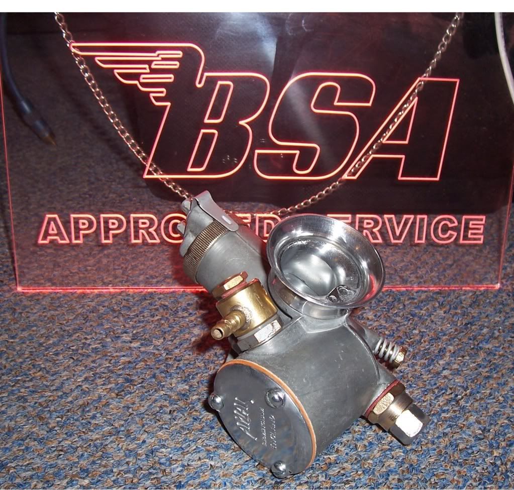

been cleaning some more at work so its ok lol. put together the AMAL 376 for the m21 like new but it was black with grime

That carb looks great Rob. What's the name of the stuff you cleaned it with?
well it was called just aluminium cleaner i bought from machine mart it was a mixture of acids and degreaseants wich was water soluble so i would mix up a 10% mixture and put all the bits in for 10mins and scrub a little with a touth brush.
it gives of a strong smell of sulphur dioxide
but good results
