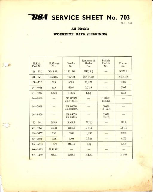

From left to right you need 65-2045 (Hoffman 125), 24-724 (Hoffman R.325L), 24-722 (Hoffman RMS.9L).
Below is the bearing service sheet. If you save it and then open and zoom you should be able to read it.
