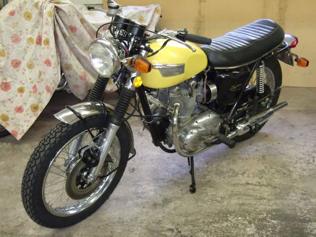

1. Fwiw, I've fitted a Triumph disc-brake front end to a '69 T100. If the A65 headstock is the same as the contemporary Triumph, you use '73/'74 T150 yokes (triple trees), 'cos the stem's the right length and the cup-'n'-cone bearings match. However, I'd advise against using a complete T150 front end, 'cos the triple's 100lbs heavier than a twin; my T100 has disc-brake twin fork internals.

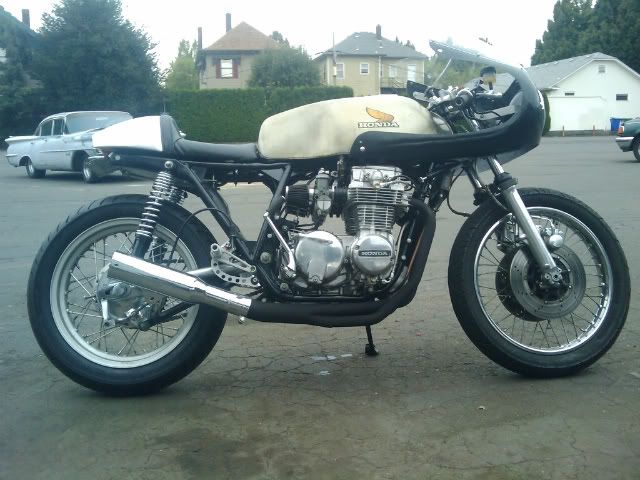

if it helps, several '70s honda CBs (500, 550, 750) have 35mm forks. i've seen them mounted to OIF bikes for a disk front end, but i don't know the diameter of your stanchions. the models listed above also ave mirrored forks, so you can use two disks.
i think it'd look funny on an otherwise stock bike, but would probably blend in fine on a race or cafe racer bike.

I used a honda CB500 front end on a T100,, used the whole thing since the triple trees are wider. In My case the steering stem length was almost the same so all I needed to do was turn out some bushings for the steering races and grind a bit off the steering stops to get things to fit. Early Honda fours use 19 inch 40 spoke front wheels, just like a proper motorcycle.

T140 disc brake front end onto a pre-1971 frame.
At the risk of a thread hijack ... without wishing to sound like a smart-arse at all ... you should've asked first ... whistle
Originally Posted By: richard p
I have made up the necessary bearing cups and spacers needed to use the triumph triple trees....
Ime and mho, an oif bottom yoke in a 'dry' frame is too much hard work and expense for the result - the bearings are different (oif taper roller, 'dry' cups-'n'-cones) so either you have to make up or buy loads of little bits and pieces. But that still doesn't make the oif steering stem long enough - you'll only get a few threads in the top nut. frown Otoh, if you use a T150 bottom yoke (top yokes are the same), it's a bolt-on ... bigt
I have acquired most everything I need with the exception of a master cylinder
I used (Sparx pattern) T160/'76-'78 handlebar switch clusters and master cylinder mounting, but with a stainless master cylinder, because that's what I wanted. If you go for Jap switchgear and master cylinder, bear in mind the standard Triumph/Lockheed single-disc master cylinder is 5/8" (16mm) i.d. whereas most Jap ones are 14mm (9/16") i.d.
and the actual hoses to get the juice to the caliper.
I made them out of Goodridge braided hose (plastic-covered) and stainless fittings, because I wanted to incorporate a proper hydraulic brake light switch (as used by Meriden '79-on) instead of relying on that ridiculous pre-'79 Heath Robinson device. mad Only thing to bear in mind is, if you want the hose bracket that attaches to the slider at the mudguard/fender mounting, you can't use normal Goodridge -03 flexible hose from there to a standard Lockheed caliper - the bend radii are too tight. I wanted it to 'look' standard so I had one of Goodridge's 'hard line' customers copy the standard Triumph pipe in stainless but, really, the much cheaper option would be to have one flexible hose from lower yoke to caliper.
And, as always, I use DOT5 brake fluid.
Pm or e-mail me if you'd like some pictures or other details. wink
