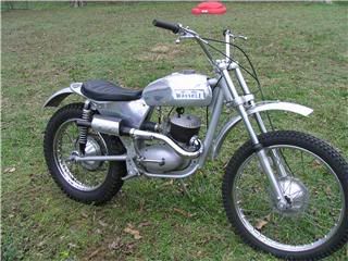

A little something like this???
One of the other "Gords"

Hey. I Like it - Thanks Gord . Front hub looks like a Rickman. And the frame, engine and forks are from which model? - Gord B

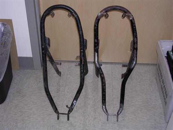

The rear frame section needs to be modified (on either) so that you can stand without your knees hitting the seat base (I have pictures).

Just cut, rotate 180, reweld.

Gord....the engine is junker (incorrect for the Wassel Trials Bantam) for the mock up....yep, wheels are Rickman and that's one of the few frames Wassel made for the Bantam.

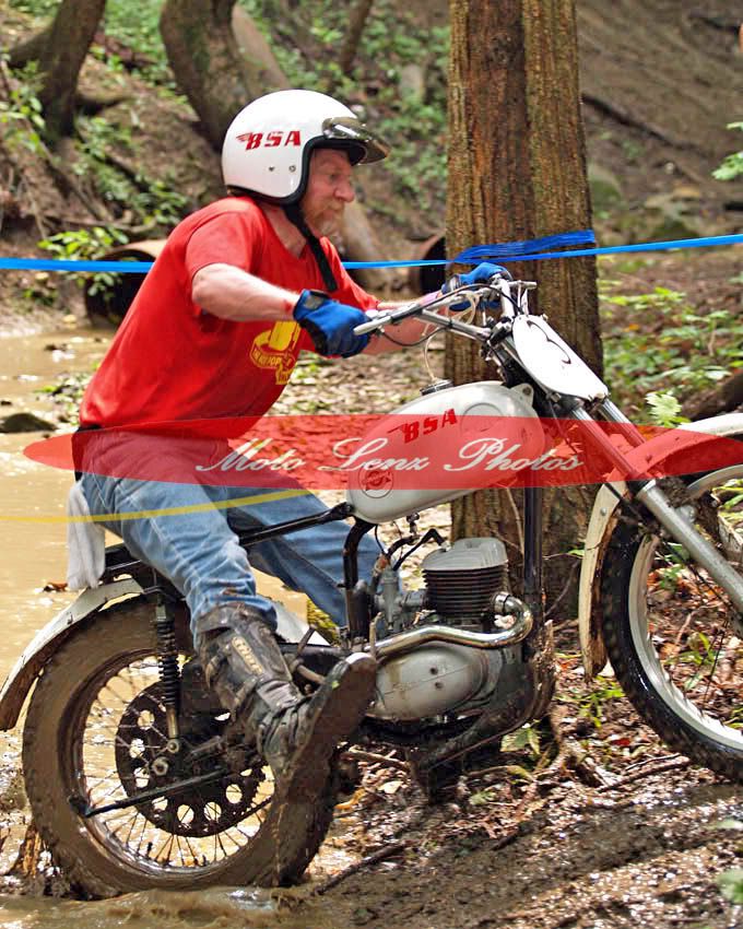

Nicest Bantam Trialer I've seen up close is ISTS's own "Chickenman's" special...but for the life of me I can't find a picture of it...but I know I have some here somewhere????????????????
one of the other "Gords"....Gordon in NC

Thanks Gordon. A friend of mine has one of those wassell frames. Very nice. I'll see if I can't track down a pic of that Chickenman's special . - Gord B
