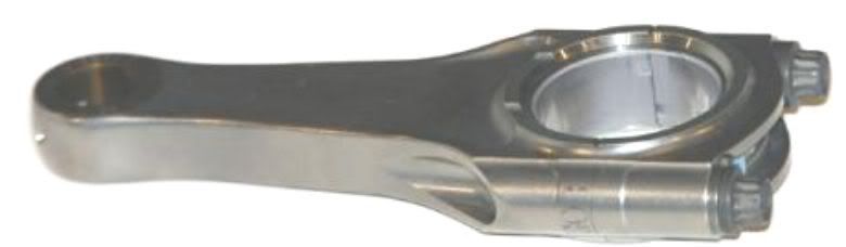

I just remembered something thinking of Ron's post about oil flow and rod side clearance, and have a question: what does the oil escaping out the sides of the rods do for oil pressure?
I'm sure if the rod has an oil squirting hole like L/H A65 rod, or commando rod it will lose a little pressure. The rods from Hondas first moto GP motor probably did not have over generous side play on the crank, because they have something else, little grooves in the upper thrust faces; have a look:
This is one of the alloy rods I use, which I guess would be similar to the MAP rods, it would be easy to put the 2 little grooves in the upper side faces that would allow more flow and also spray oil up at the piston, which could cool it. Maybe that might also get rid of some of the Triumphs excess oil pressure?

Mark, yes that looks like a map rod from a few years ago. If from srm it may be.You are along the right lines as I run squirters off the PRV to help cool the piston and rod.You don't want the oil to back up at the rod sides and if you can direct the oil up then that can't help but be good.Aluminum parts must be kept some what cool or its life is shortened very fast at high RPM. To the dyno today to see how the short rod compairs with the long rod.Although its 90DEG at 8:30 in the morning.

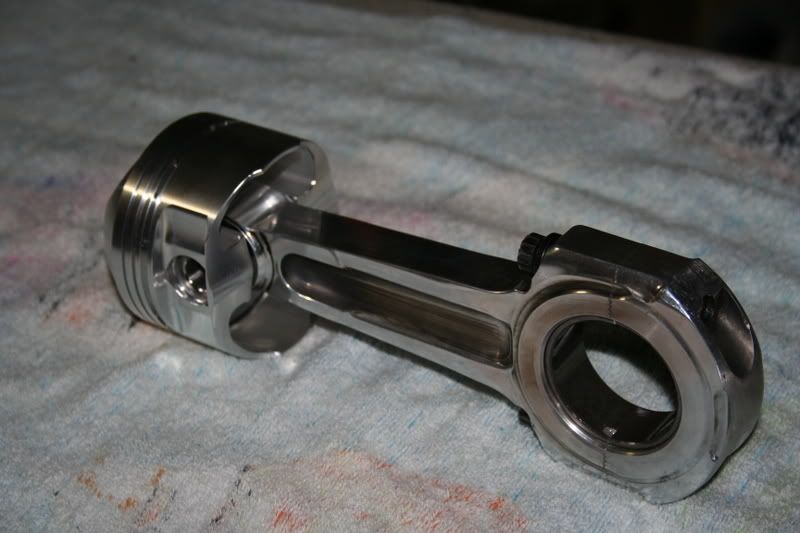

Here's some more detail. The adjustability of Tim's frame is awesome:
It is early days for me with the new pump set-up, no problems so far. Mine is a road bike and I am breaking it in. I got 60 PSI with the plugs out checking the return within four kicks! I have 70 PSI max and it is there from just over 1000 RPM. I haven't had any of the problems written about priming difficulties, loss of prime, inverting seals , burning oil or leaking, just a good steady stream of oil. Can't tell about cavitating because the oil at the top of the tank is always frothy due to the nature of the higher flow return on all pumps.
Blapper redwine

Wow! Great info! thanks for sharing it with us Tim. Notice that the short rod is not quite up to your long rod output wise though - yet anyway....
Meanwhile at the other end of the spectrum, unfortunately I don't have access to a dyno except for one at a modern bike shop that charges $78 per hour session. Still might try them though. Meanwhile trying to get my Veypor Logger working - at the moment can't get it to do anything. frown Next step is to send it to Nonlinear Engineering (the supplier) to have a look at it.
