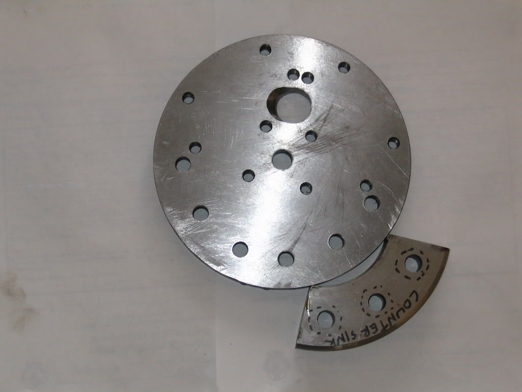

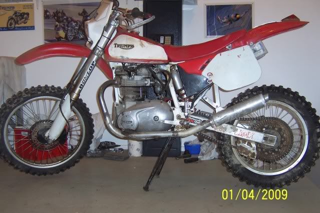

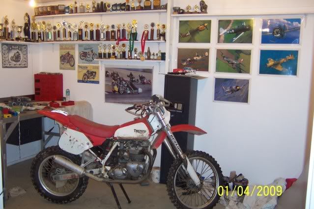

Gday Mark, here is some pics I took tonight after work. This engine was a genuine Boyer race motor as described in Stan Shentens book. It does not have engine numbers but has the triumph logo all over the pad where they normally go so straight to the team from the factory I guess? Note the ground away clutch cover where the altenator would have sat, they must have leaned these things! The front engine mount was shortened 45mm to give the front wheel clearance. I used to run a 2 into 1 exh system up high but couldnt run a decent aircleaner so now the twin system. It also protects the oilpressure sender. I took the close ratio 5 speed Quaife gearbox out and swapped it with my '76 bonny box. A tall 1st was a pain in the bum in the bush.
The fuel tank is off an old Montessa with a bit of work done to clear everything. Nearly everytime I go away for the weekend it springs a new leak. I hate working with fiberglass, this tank weighs more than a Sherman tank and still weeps. This pic also shows my second passion, piston powered fighting aircraft. My grandfather was a Halifax pilot in '43-44 with the RAAF in 466 sqn and told me lots of stories, If Im not playin with pommy bikes Im reading about pre Korea military aircraft.
This pic shows the internals for the race sidecar. Note the funny looking cams and the amount of material removed to clear the conrods with the 89mm stroke. You can see the cam bushes have been exposed. The oil pickup tube also needs to be slightly modified to clear the bobweights. This is not needed on a unit motor. The 76 deg crank still has the MAP norton rods and slightly modified T140 pistons on it. These will go on the 90 deg crank sitting next to it for consistency. The head has been bathtubbed and a new addition is filling the inlet ports with resin, hence the holes under the inlet ports to give extra gripping area. I run on methanol so I dont want to run the risk of this stuff getting ingested if alcohol affects it. I bought the resin from the U.S. and the tech person said it was OK for alcohol so just a precaution.
This is where it all starts, a flywheel made from 4140 and mild steel counter weights. This is the 76 deg version.
The next hurdle is finding $500 to have the cams made to suit the 90deg crank. I still run points on the staggered crank motors but a Boyer on the 360 dirtbike.
Hope your helps your cause and answers a few questions.
Cheers, Chris.

Wow! Chris, thanks for the pix and info, that's great stuff. First that CR818 is awesome, just what I need to Trump my buddies new F800GS beemer. I see another project looming, I've got to get my rear in gear. Do you know the overall wt. of the CR?
Your head mods are what I had in mind, weld in the sides of chamber & JB weld for port floors. I've found no 2 ports even close to being identical on these old bikes. I could make a few phone calls to ck availability and cost of offset cams if you like Chris. Last time I talked to Keith Johnson (2 yrs ago) he said an offset cam was no problem and same price as std. cam which I see now is about $385 US, probably not cost effective with exchange rate & shipping however.
I've been aircraft mechanic last 31 yrs., my dad flew Douglas A26s in Korean conflict. He was also our motorcycle inspiration, his last new one a 1962 Honda CB77 we brought from Japan after being stationed there 3 yrs, we still have it & it's never been apart. He rode AJS 500, Tri 500 and cub in the Michigan Jack Pine enduro in the mid 1950's...good stories. My brother currently restores WW2 fighter aircraft for an outfit in Southern Calif., last month was working on a Hurricane, this month big push on finishing up another P51, you would go crazy if you saw what's in the museum down there, no Halifax that I'm aware of.
Thanks again for pix, I just have to decide on what I want to do now, I think I have enough information...thanks, Mark
