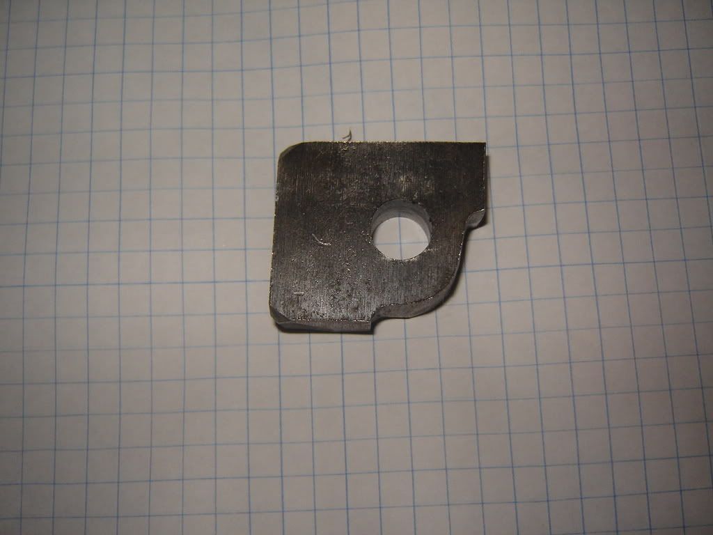

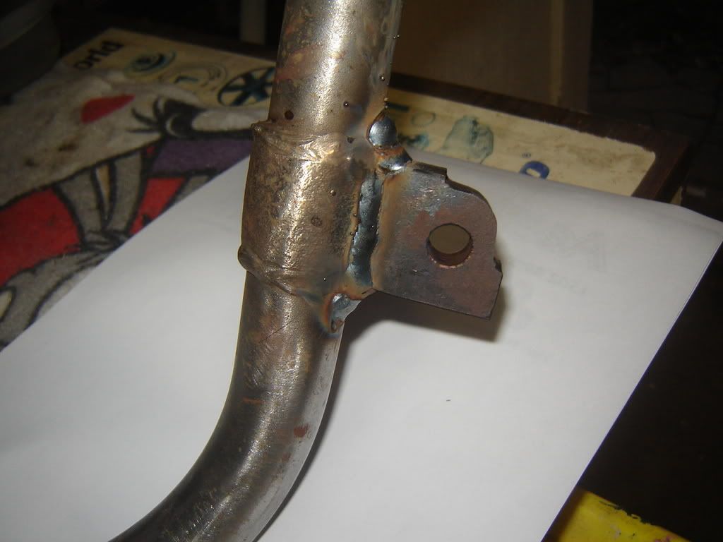

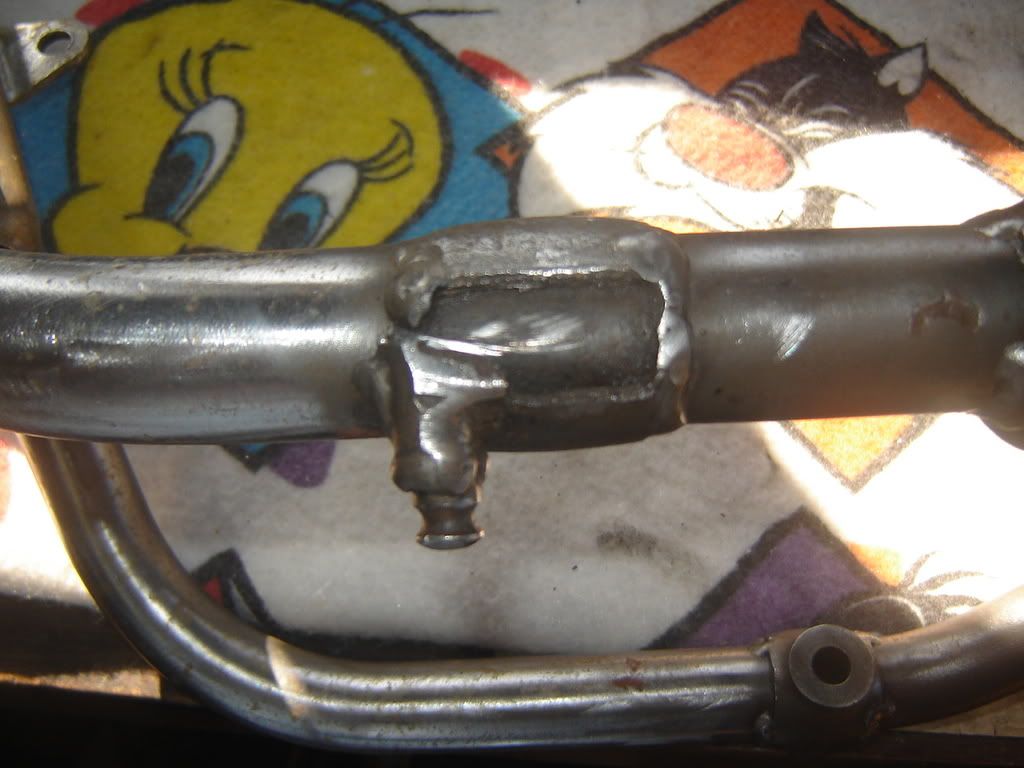

I traced the lug from another bike onto a piece of paper.
Transferred it to a piece of 1/2" steel and cut it to the rough shape with a cutoff wheel in a die grinder and finished it up on my bench grinder. It took less than an hour and cost nothing.

Hey great timing! This evening I just took delivery on a 69 TR6C frame with no side stand mount. I was going to start the arduous search for the piece or fabricate.
Thanks desco, Shel that looks great!

I nearly skipped fixing it because I would have a center stand anyway and I don't have any metal working/fabrication experience but I thought if I didn't fix it at some point I'd regret it.
