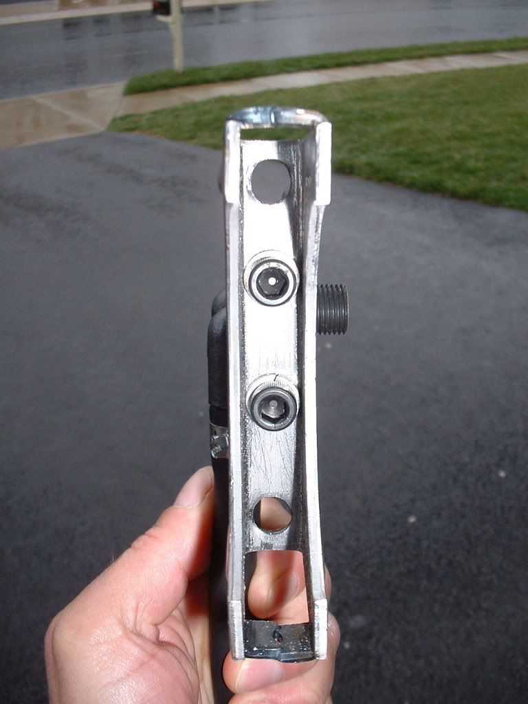

Posts: 7,272
JubeePrince Offline
JubeePrince  Offline
Posts: 7,272
Originally Posted By: Mark Williams
Is the Norton filter easy to mount or does it require a special bracket?
If so, does anyone sell a bracket for it?
I bought the Norton filter head by itself and bought a $3.00 muffler clamp from the auto parts store.....this is for an OIF mind you, the down tubes on the dry frames are considerably smaller (1" - 2"?)....you should be able to find a U-clamp in that size.....
I also use the threaded bush sold by CNW (not shown) so I can use standard auto filters.....
Including new oil lines, I think the entire outlay was less than $60.00....

Mark, here is a photo of a Trident-type oil filter on a 68 T120. It is hidden when the side cover is installed. I have to unscrew the aluminum mounting bracket and tip the filter housing outward to install the filter element, but it's a small effort for a pretty sanitary-looking installation. This particular filter kit is similar to the one sold by MAP -- perhaps a bit nicer looking but also more expensive. I believe British Cycle Supply has them if you are interested http://www.britcycle.com/Products/631Series001.htm
