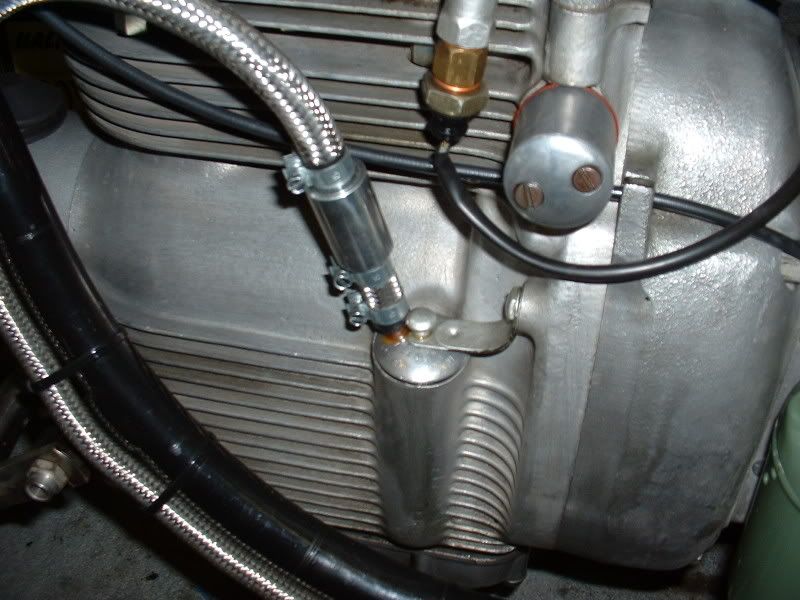

I've got a Krankvent ready to fit on my T140V when I get enough parts back to start reassembly mad
They are pricey, but very well made and I've had experience of fitting one on my Sunbeam S7. On the Beam the factory fitted breather is in the front of the rocker box-cam cover and on a lot of Beams it's prone to failure and difficult to fix. I'm not convinced they ever worked well which is why you see many Sunbeams that have been ridden at all hard with engines smothered in oil. A new breather can be fitted in the dipstick cover and I attached my Krankvent there. It works really well and has done a few thousand miles since, keeping the engine clean. All I ever get out of the end of the vent pipe, which is run to the rear of the bike, is a little emulsion where oil mist has mixed with condensation. I did try adding a smaller intake valve on the cam cover at one time, but found small oil seepage's occurred at high speeds, yes my Beam will do a tad over 80 mph but I don't make a habit of it, it's a rare occasion. All these older engines are far from air tight and are quite capable of drawing in air to replace some that is pumped out of the breather. You're not after a vacuum, just trying to obtain negative pressure and the Krankvent does a good job and seems to be very reliable and long lasting. So far I've not heard of one failing. The only downside apart from the price is the noise, you can hear the thing working.
A Couple of pics to show how clean it keeps my Beam and I don't clean the engine very often, no need.The second pic shows where I've re-postioned the device to allow oil to drain back down the outlet pipe, not that there has ever been any evidence of oil being blown out, just thought it made sense.
