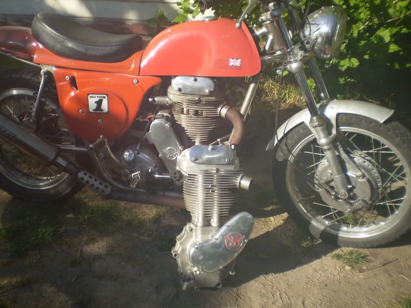

WHAT WOULD U CALL A MRD metisse with a Alcohol burning
puma 2 valve,
Fitted with a Munch Mammoth front Drum,
is this the Ultimate insane job?

I made some replica Munch front drums,
one is fitted on a commando 850
the bloke is not far from here and will get
a picture of the front end i set up,
i was not going to think i would work
but the bike stops good,
The castings are AZ91 magnesiumm
liner is shrunk in .
the drum is approx same size as a TZ YAMAHA,
BUT IT WORKS BETTER THANN A TZ DRUM,
I THINK THOSE SUCKERS GROW TOO MUCH
JS
