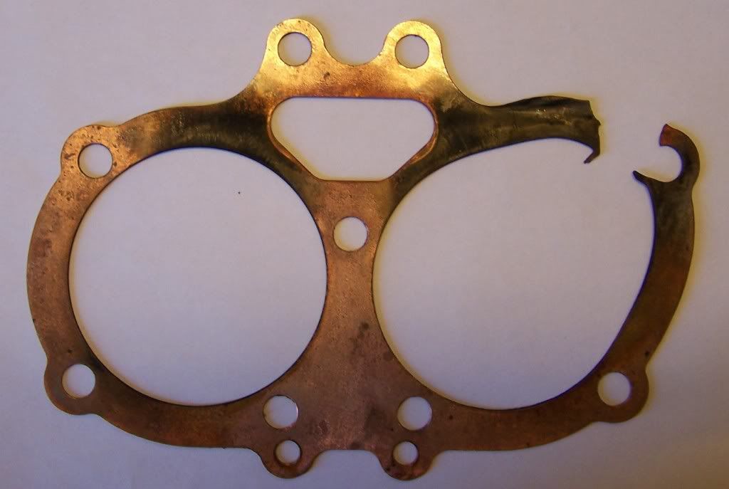

Re: Composite or Copper? [Re: Snakepitt] #226114
11/30/08 8:04 pm
11/30/08 8:04 pm
Hey what do I see? confused
Hein posted a picture of my BSA A-65T head gasket, which blew out in april. It was mounted with a thin layer of copper grease on both sides, and the one after that (which is still alive) also is. It failed as a result of head nut failure. So never say never, Madigan wink It's failure had nothing to do with not retorqueing it. The nut was to soft for the torque applied, so one might even say it failed as a result of torqueing.
I feel better when I use copper grease, so maybe the only value is psychological.
I used a composite gasket once and only once. The deformation / compression goes so fast that you need to retorque practically 10 minutes after first start and than every 100 km (80 miles) for the first 2000 km.
Sorry Ger, for violating your copyright, blush It seemed to me that this picture fitted seemlessly in the discussion.

Re: Composite or Copper? [Re: hein weijers] #226899
12/06/08 3:33 pm
12/06/08 3:33 pm
You did not violate anything Hein smile. I could not write my post without mentioning that I at least knew this gasket. So don't worry. Or better... yes do worry: you owe me a cold one.
