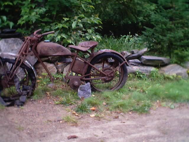

Trying to send a picture of the latest AJS find . I think it is a 1929 250cc . Pretty good condition despite the fact that it layed outside on it`s side for enough years to rust thru the gas tank and oil tank . Have robbed the fenders for the `26 project , may also rob the hubs .

[IMG]http://i213.photobucket.com/albums/cc228/johnsruff/HQ0-2.jpg[/IMG]

Followed Shel`s step by step instructions several times and I finally got a picture to post . Look out Forum members , now that it has started there may be a bunch more pictures of projects and semi completed bikes on the way .
