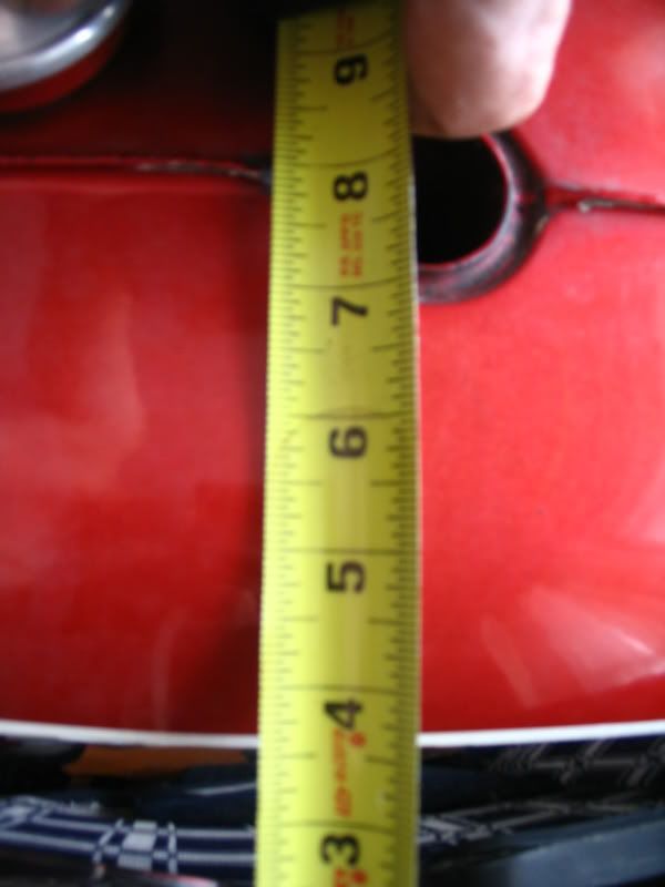

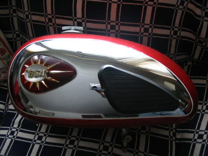

For the large tank seen here:

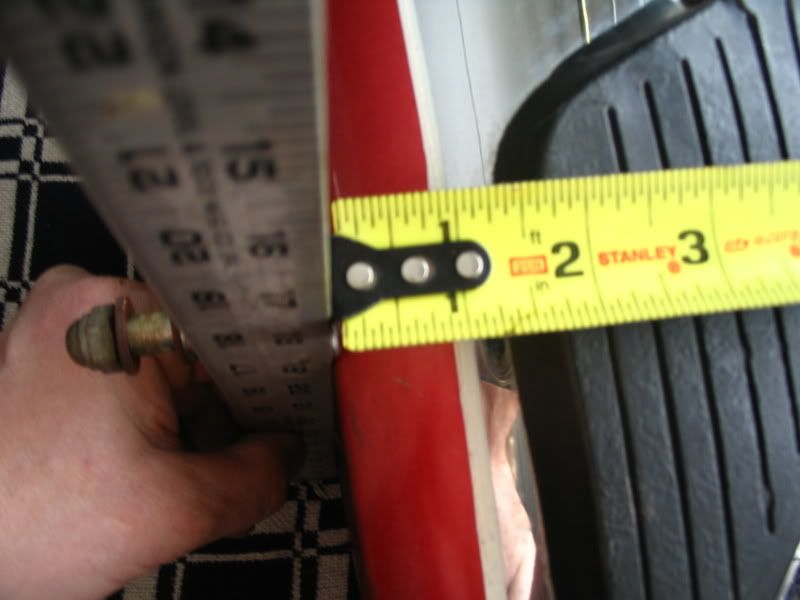

At the bottom edge It's seen here:
At the top I got 4 3/8:
