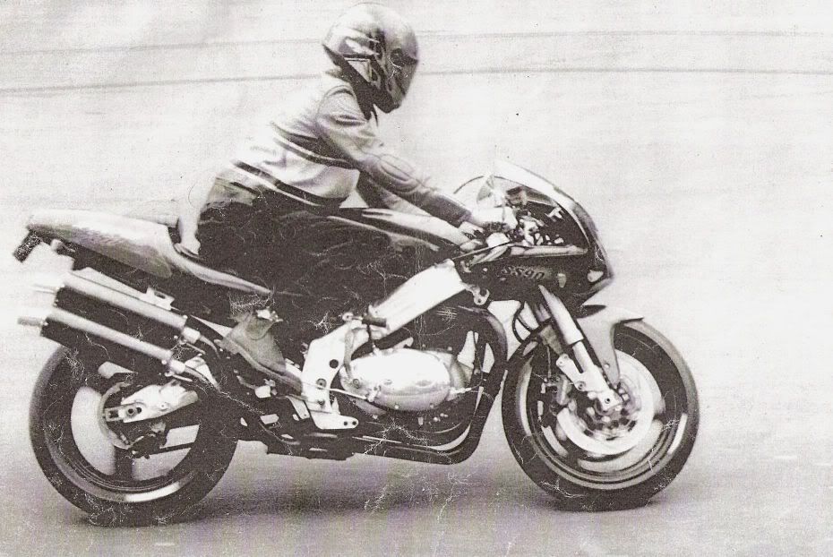

My son Ben has a tweaked SV650 and it is very fast, He also has an A65 we are putting back together with a 750 Cyl, and we are aiming for SV type performance. Analysing the SV's engine characteristics with his data logger shows up the fact that it keeps producing good torque up into the higher RPM 9,000+ meaning good HP figures and performance, I'm confident the 750 A65 running to 9,000 could match it if we can get a not too peaky power curve.
What's good about the A65 engine is how small and compact it is, ours are both in 250 frames, and though not eligible for F750 with stuff this modern they might allow a Rob North style frame with twin shocks, that would work very well with similar geometry, weight distribution, and swingarm length. This photo shows Bens, and you can see how far forward the engine can go, which is an advantage handling wize over an SV with its 'V' engine having to be further back with the swing arm shorter. The weight distribution is 55% front 45% rear. It is very noticable if riding this BSA fast, how excellent the handling is.
This is a video of Ben's BSA at 650cc, My BSA is 883cc with virtually the same head mods, but the bigger engine runs out of breathing at lower RPM and has a limiting longer stroke. The 650 pulled hard to 9,000. (Though in this video it has a missfire!) I think a 750 would be the best size for racing, the bigger bore I think unshrouds the valves and the shorter stroke lets it rev.
They might let you run in BEARS with one of these rolling chassis, which are quite cheap, (Suzuki RGV250)not imported to the US but went just about everywhere else. "M" models '91, are probably best.
