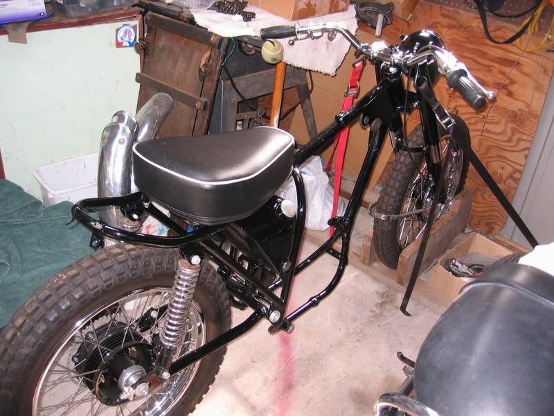

I found this out in the driveway the other day....
The next morning it had moved up to the front porch
Looks like it could become a running motorbike this year. Little bit to sort out yet, lotsa spacers and cups to clean up the Van-Tech front end and Bultaco wheels.

Don, is that the Van Tech front end you got from me? Wow!! You've done a beautiful job with it!! Can't wait to see the finished bike!
My bike Gemini (one of the "September" bikes in the calendar) is the rest of the bits left over when I sent the forks, plus quite a few others.
Nice to know nothing is wasted, huh?
Great looking bike!
Barb, the Shed Girls, Big John, "XS" & Tiny Toddler
Barb (Three MustGetBeers)
"Midnight girl in a sunset town.."
Britney the B44
Bella the '69 T120
Pip the Triumph (I have "Great Expectations!")
Jaelith the '77 XS650/chair
The unnamed '79 XS650 with...potential
Millie the R80 BMW--she's "Thoroughly Modern"
Re: BSA B44E #19227
01/04/07 12:46 am
01/04/07 12:46 am
Posts: 2,405
Posts: 2,405
Yep Barb, that's the better half of Gemini fitted up to 66VE eBay frame.
Many thanks to Paul Shuddick (queensiron441?) for allowing the canibalization to occur and to you Barb for going to the trouble of buying half a bike and shipping me the rest!
441Steve turned some spacers for a better fit of the Timken tapered rollers. The frontend was fractured up top at a few places so I had to fabricate, gusset and straighten a bit. I think it's OK now, won't know for sure until I get it up and running.
The swingarm bushings turned out to be the biggest *****, but I was determined to salvage it for the extra 2" that was added to each arm.
It has a 55 1/2" wheelbase with 11 1/2" of clearance at the moment (unladen).
Looks like a loper to me.
Those Bultaco Akronts come with stainless spokes, pretty cool, shaved a bunch of weight right there but lost a bit of brake surface.
Trade offs...
High Point tank meant for a Husqvarna, and a mystery seat. Still need a rear Stainless fender to match the front one.
I've got a real clean 70VS engine that should bolt right in.
This is the first non matching numbers bike I've ever tried to resurrect, started with just that $30 frame and swingarm. I'm going to do my best to get it "legal" here in Ca. Just need some tabs welded to the forks for a Super Oscar headlight!
Don in Nipomo :bigt:

Nice machines Don and oily, is that an IRC or Avon Gripster on back wheel? Looks like it may help at speed when dodging cars on the shoulder of highway LOL!
Re: BSA B44E #19238
01/06/07 1:54 am
01/06/07 1:54 am
Posts: 2,405
Posts: 2,405
Hey Steve!
Bridgestone Trail Wings, they were take offs from a Yamaha XT. I think the series design started with Honda Mini Trails...
Sharp looking pattern that I couldn't resist... and cheap enuf for me at $30 for a pair. Highway rated and the bead isn't all that tough, easy on and off with the alluminum irons.
