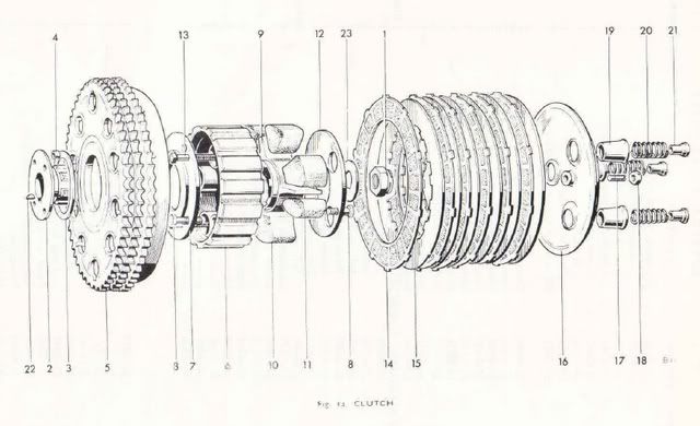

1. Re laundry and vacuum...get a girlfriend and more beer
2. Re clutch basket ...get a manual and a parts book,and more beer....

That's interesting, I see three primary drive (?) sprockets on the left there, my machine has two.
RE girlfriend, I've got one of those "modern" women that are single moms and work all day and have the kid at night leaving me to do laundry and vacuum. Luckily, I have a well-developed taste for hop-flavoured water.
Thanks for the cool picture. I don't see that in my CD-manual.

thats out of my 76/77 parts cat...just to give u an idea...
...im single,so i have to do ALL the chores with out the female benefits :rolleyes:

So I also wiggled the primary with the little slack that it has in the chain around the crank. Annnnd I can't tell if the clutch basket is rotating or not. I mean... does 1/64" count as moving? It's pretty tight.
I remember that when the gears were... in gear, and I'd pull the clutch in, the kickstart would *WHOOP* slip right down. Um, I can't pull the clutch in anymore, so I can't really test that.
Any ideas for a next step?

well if it was me id put away the hammer,chisel and dynamite and bring out the manual,some patience and plenty of cold brown liquid and start some gentle investigative dismantling....id start with the clutch assembly then, as suggested ,the head... 2c

Hi Eric, and all,
Sorry I did not read your original post well enough. I see you shut the bike off.
You took the "kicker plate" off? Right. What is a kicker plate? You mean the plate at bottom of tank/frame? You found which engine fluid to be watery? Engine oil? Primary oil? Gear oil?
You stored it indoors? Where? A shed? Barn? House? Was there constant heat? Or sometimes? Worse is sometimes.
What was last ride like before storage? What the temp and humidity? Like where did all the water come from?
Like others have indicated, maybe the clutch is just stuck. Cable on yet? Pull clutch in and tie it open, and wait a night.
Although rolling it with plugs out should move pistons. Try it backwards on an incline. Worked for me. Bunch of mmm came out exhaust pipes and way she went. That was 5,000 miles ago.
Was the wire mesh screen installed in tank? Was it intact?
Hope that is all. Good advice is to change engine oil after storage BEFORE starting. And kick it a bunch of times before starting.
