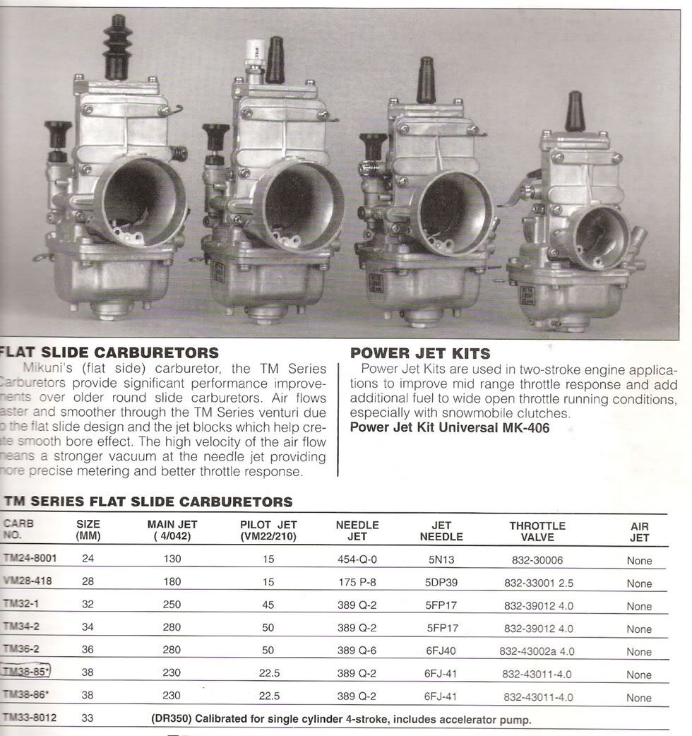

I am looking at using 32mm Mikuni TMs on my mildly tuned (balanced, polished, hotter cam) '78 T140 motor. Does anyone have some starting point as to what the set up should/could be? Any other comments or thoughts are welcome.
Thanks, JF

Maybe;
I have only used 38mm so don't know how close this will be with the 32mm size but its definitely where I'd start.

Please note that the settings in the illustration above are only how Mikuni supplies the carburetor for almost all purposes. It doesn't say single, dual, engine size or even air vs. water cooled, 2 stroke vs. 4 stroke. If strong vacuum signal is a feature, why the rich jets (45, Q2, 250)?
It can't be too far off, because M.A.P. sells the same numbers. However, Sudco etc. used to sell the VM by the same method: pick the closest generic Mikuni factory jetting #, and ship it. They weren't very close.
On the plus side, they use the same common pilot and main jets as the VM, so those parts will be easy to find. Expect some work to straighten these out. It's only a better carburetor than a Concentric or VM if the jetting is accurate.

Probably the jetting will be rich, but at least that's safer than the alternative. I don't have a good mental picture of that slide size (4.0), but the TM sizes don't run like VM so it may be fine. With any luck a few needle jets will be the only expensive parts since I see the std. needle is dual taper, which is what I generally start with.
I would prefer the RS, but of course pairs are $$$ and used you have to get 4 (usually).
