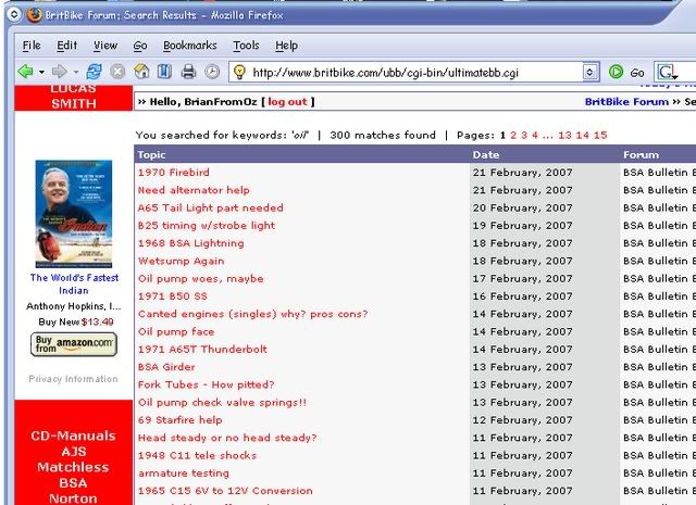

leon,
I have tried to scan through old posts and use the search option, however, neither seems to work to well. Try it sometime and you will see what I mean. As a matter of fact, I tried to find out about any posts concerning the best oil for motorcycles. I tried a search using "oil",
"best oil", "motorcycle oil", etc. and not one post concerning oil came up! I am also tired of members saying when someone asks a question, to just look it up in the posts. In case you wern't aware, there are over 50 pages of posts on this site. How hard can it be to just answer someones question to the best of your ability even though it may have been already covered sometime in the past. I would think that the hole purpose of this site is to educate new owners of British bikes and to enhance the ownership of all British bike owners in an attempt to keep this experiece alive. Maybe I'm wrong.

I am surprised you can find anything wrong with my reply. I've been reading this board almost daily for I guess about 4 years. I sometimes scroll back page after page looking for something. I also use the search, have used it just in the last few days. I searched "how to post a photo", and "crankshaft balancing". Got good results, too.
There really has been quite a bit of recent discussion of pumps, maybe you were in on it? John H. has mentioned the 4x pumps. As for oil, that has been discussed so much that if you searched you might break the computers! Anyway, good luck, I hope somebody comes along soon with some usable info before you get irritated.

The search only took me a minute to find about all there was on the 4 valve pumps, you're right- there isn't much. I read your posts from a few days ago. What are you trying to learn? At this point, you may be the expert. Are you hoping to affix blame?
Am I aware there are 50 pages of old posts? Yes, I've read every single one. Literally. If the board hadn't crashed a couple years ago, I guess there would be well over 100. Thats just Triumph, wait till you get a BSA- then there's another 40 pages over there. Plus, you need to read all the Brit in General posts.
Have you tried asking over at the Triumph Rat board? Not as busy over there, but there are a few guys there who know a lot.
