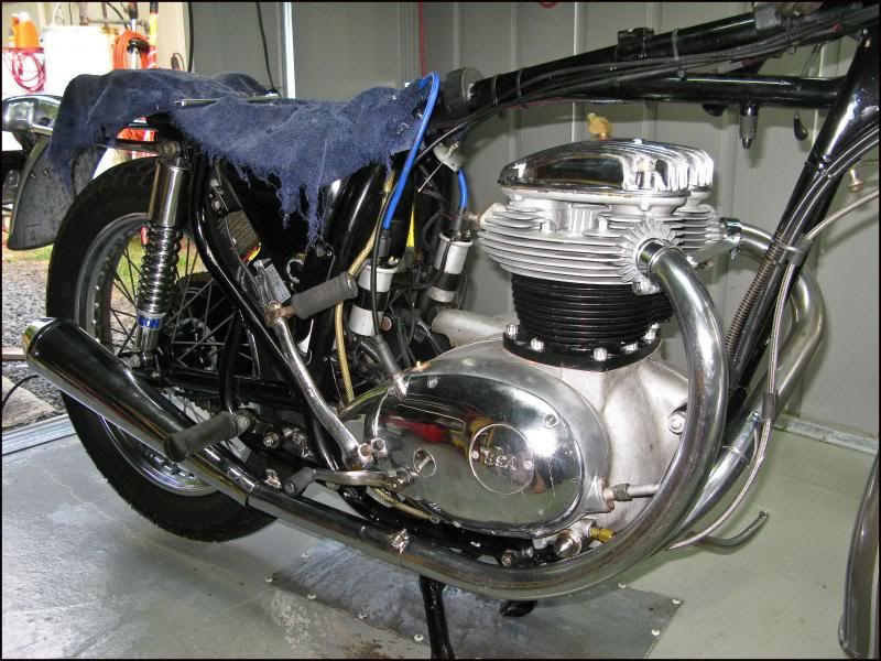

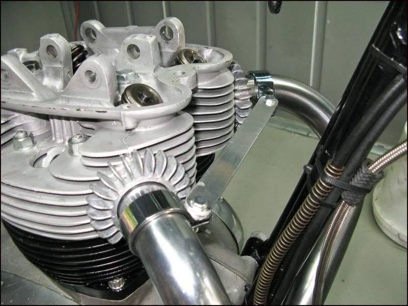

There was no crossover tie with them so I came up with this.
I used one of my old megs with a kick up so it came just under the footrest.
I even like the look, left side has more of a race bike look to it. So I say go with the Siamese pipes.
