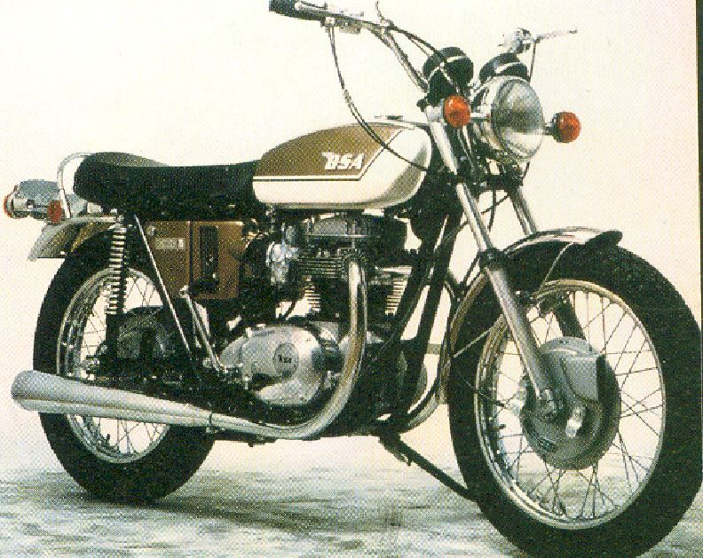

Gents, i am going to be painting my 72 thunderbolt , besides the bronze color, what would my other original paint options be? Does anyone have paint codes?

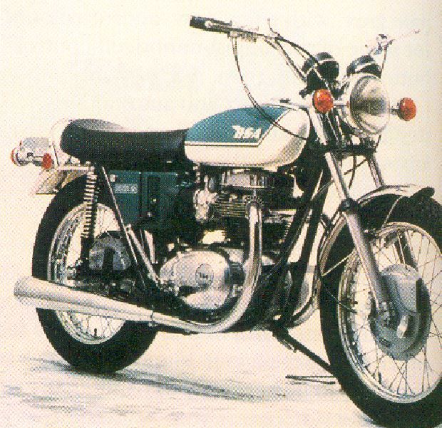

For 72' I think the only option was bronze. If you don't mind the 1971 colour of green, these can look quite nice.
http://www.bsansw.org.au/catalogs/1971/71r6.jpg
the colour is known as stirling moss green.
http://www.rsbikepaint.com/en-gb/colours.php#makeid=23&modelid=566&prodyear=1971
I have bought the RS Paints version of Sterling Moss Green and it's nothing like it! Theirs is flat and too dark!
See here is the original tank and the inside of a side panel I sprayed with RS Paints version.
The flash from the camera does alter the actual colour of the tank but you can see the RS Paint is miles away!
A Better likeness of the original tank
The closest is a UK colour of Rover Kensington metallic green but you will need your paint man to add a bit more metallic, I took in my original tank and that is what he mixed.
The white is UK Ford Diamond White.
Not that it is relevant to the year of your bike but RS paints version Of Dove Grey is RAL7032 when in fact the correct colour is RAL7044.
So if you are going to get a colour that is anywhere near right see if you can track down an original and get it colour matched.

i dunno. but in 1975 the effect was close to the tank but not as bright as I remember it, the panel is way too dark.

That's interesting Andy, although RS say it isn't a candy, the original looks like it could be with the it having the metallic look to it and it changing a little in shade as the position of the camera alters.
(and see image 2 for the inside/outside aspect, the bright light shows its true colour, other wise to appearance of too much paint shows through)
Candy top paints will be really dark like your side panel if:
1) there is no candy base coat
2) too much candy top coat is applied over base
3) no lacquer applied or lacquer rubbed back ( and that makes it seem darker than no lacquer at all)

I went through an exercise to try to get the code of the 1972 Bronze. I have to admit I have no memories of seeing one when they were new, but I rather liked the color of this one -
http://s1312.photobucket.com/user/R...BES72_16_Giant_Test_zps13b72c6e.jpg.html
(1972 BIKE magazine test of A65L)
I found a couple of side panels in green and bronze that looked like factory paint, and got them matched by Dupont. I received from them two test panels:
http://s1312.photobucket.com/user/RJG9/media-full/Mobile%20Uploads/IMG_1277_zpsef023bdc.jpg.html
and an ingredients list for the bronze:
http://s1312.photobucket.com/user/RJG9/media-full/Mobile%20Uploads/IMG_1273_zps310f0a29.jpg.html
My understanding is the Infiniti color is a close match, the ingredients (including metallic content) are specified as shown.
Unfortunately I cannot find the ingredients for the green one....
I should say the bronze turns from a bronzey color to an orangey red as ambient light becomes brighter. The test panel picture was taken with a flash so looks more red.
How close a match is it to the correct color? I am not sure, although it does look very attractive, especially under street lights. The Bike Test bike was a Lighting, not a Thunderbolt, so theoretically should have been red.......
