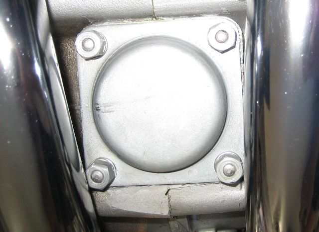

Did you ever get the sump with drain plug working with the TT pipe setup?

...Did you ever get the sump with drain plug working with the TT pipe setup?
See the attached image. No room for longer studs required for the thicker alloy sump with drain plug with the TT pipes. About the only method would be to weld a thin nut on the bottom of the stock sump. But since wet sumping is really not an issue on this particular machine, the change is a bit pointless. To remove the stock sump now, the left pipe has to be removed first.
