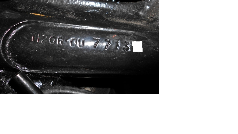

Hello
I started of another topic titled: Just put a deposit on a 1968 T120R....
Before I pay the balance I want to make sure it is a genuine bonneville. Do the following engine and frame stampings look correct? Is there anyway that I can quickly find out if these numbers actually do belong to a Bonneville? I have just joined the Triumph Owners Club but I don't think I will get a quick response. I know of someone who recently restored a what he thought was a Bonneville and it turned out that the DUXXXXX belonged to a Trophy. Someone had removed the TR6 part and re-stamped T120.

I've never seen engine numbers that look like that. My bike is 1,052 before that one and I don't know why they would have changed that much.

Can't advise you as I'm not an expert. If you're lucky, perhaps John Healy might give his thoughts on this, as he has discussed number stamping and bogus numbers in the past.
Below are some pics of 68 stampings on raised pad. I think most are legit, but suspect one or two of them.....

You could try contacting the Vintage Motor Cycle Club in UK.
They hold the factory despatch records.
They employ a full time librarian who is pretty good and could look it up for you.
Might cost you a membership though!
They could tell from the number who the bike was originally despatched to (the distributor in US) and the model.

As long as you do not want a certificate the VMCC will email you back confirming if 7713X left as a T120R or as another model which should count most of the way. The stamping looks ok to me, just looks slightly diff as the numbers are ingesting dirt .

Thanks for the photos. Which ones do you think are suspect?
Ok, panic over I think. I Just had a reply from the seller and he has a VMCC dating certificate with it so I'm a bit happier now. I don't know why he didn't mention it when I viewed. I suppose I should have asked if he had one. According to the VMCC it left the factory on the 3rd of Feb 1968, he didn't say where it was going to.

I'm hoping that the bike that I am looking at is genuine; the VMCC certificate should show that there was a Bonneville made with these numbers, it's a matter of finding out that the numbers are still on that bike hence why I posted the pictures of the engine and frame numbers. I was hoping that those familiar with the marque can confirm that the fonts and sizes are correct.

Sorry but a V5 means nothing in terms of knowing if a bike is genuine. And a dating cert from before they were required to see rubbings of the numbers is not much use either.

As stated above, give the VMCC Library a call (01283 495105), or send an email (library@vmcc.net) and ask them to look at the card index.
They'll be able to confirm the model that held that number, and something about the spec (home market, JoMo, TriCor) depending where it went out of the factory, as well as the date of shipping - for example, my TR6R, DU566xx (about mid-way through the 1967 numbers) went to TriCor, leaving the works on 18/1/67.

Your frame numbers look like my 68 Bonnie including the 7's & same for the case numbers. My stamped 7's are identical to yours in both instances. Obviously a different set of stamps for frame & case. Mike

Numbers look fine to me, but my bikes do not have that whited out area.

I phoned the VMCC today and within a couple of minutes they had confirmed that the numbers correspond to a T120R so it looks pretty genuine to me. Panic over I think.
