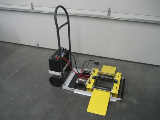

Success! In case anyone is interested I connected the 12v battery charger to the battery leads and was able to get a spark on both plugs by turning the ignition key on-off.
Next step was to leave the ignition key in the on position and crank the engine with the kickstart and again a good spark on each side, proving the sender unit / reluctor works fine. Not bad for a electronic unit which is probably over 40 years old!
So now to set up the carbs, refill the oil drained when shipping from USA and squirting Easy start down the carbs to see if it will run.
Then on to petrol and checks that the oil returns to the tank.
If it does then at least I'll have a running restoration :-)

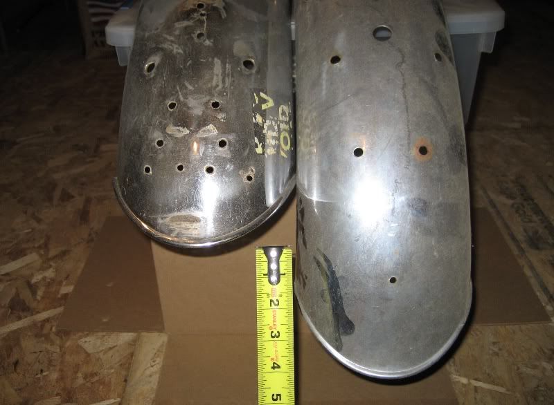

Posted By: SidSnot
Re: Hornet, Wasp, Spitfire Hornet, Cyclone (Restored) - 07/09/13 5:50 am
Measuring up the front guard stays 2 that have 12 inch centers and 2 are 12&7/16 Centers. The parts book, well my early one, shows them both as 12 inch 42-6560 so what are the other two off? Also the center tab bracket is shown as a plain stay 68-6547 which I take may also be for the 65 & early 66? I presume the correct stay would be the same as the 67 ie with an 'L' lip on it?
Sid
Posted By: Gary E
Re: Hornet, Wasp, Spitfire Hornet, Cyclone (Restored) - 07/09/13 10:44 am
The short stays are for the east coast fender, whereas the longer stays are for the west coast fender. The longer ones usually, but not always, have an "H" stamped on one end of them near the mounting hole. The straight center bracket is for the east coast fender, whereas the bracket with the 45 degree angle is for the west coast fender. There is a third type of bracket that has a 22 degree angle, but it is for the '68 models, and not for the Hornets.

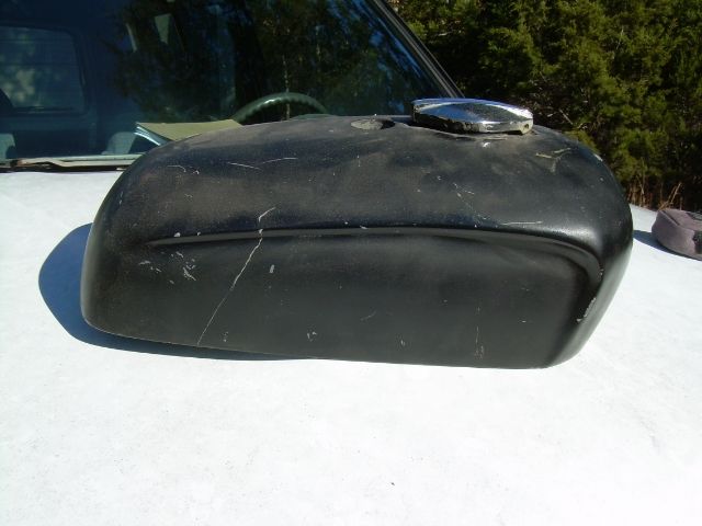

Posted By: Richard Phillips
Re: Hornet, Wasp, Spitfire Hornet, Cyclone (Restored) - 07/25/13 6:11 pm
Here are some photos of the Indian Steel Hornet Spitfire tank. It sat about a 1/2 forward. The filler cap mounting also need some finessing front and rear so the cap would fully open and lock. The petcocks were tapped for Triumph lever type so the fuel lines have to be modified.
Not a bad tank, but attention to details is lacking.

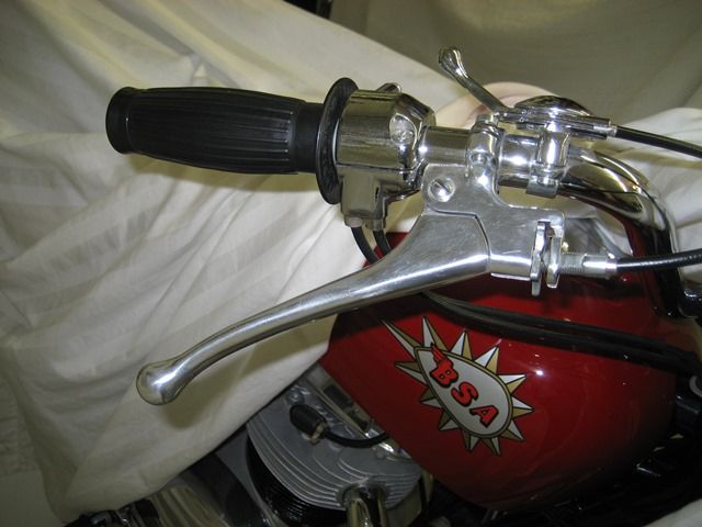

Re: Hornet, Wasp, Spitfire Hornet, Cyclone (Restored) - 08/20/13 8:47 pm
KILL SWITCH
NOS kill switch, holder, and clamps, in the correct position on the handlebars (according to the factory).

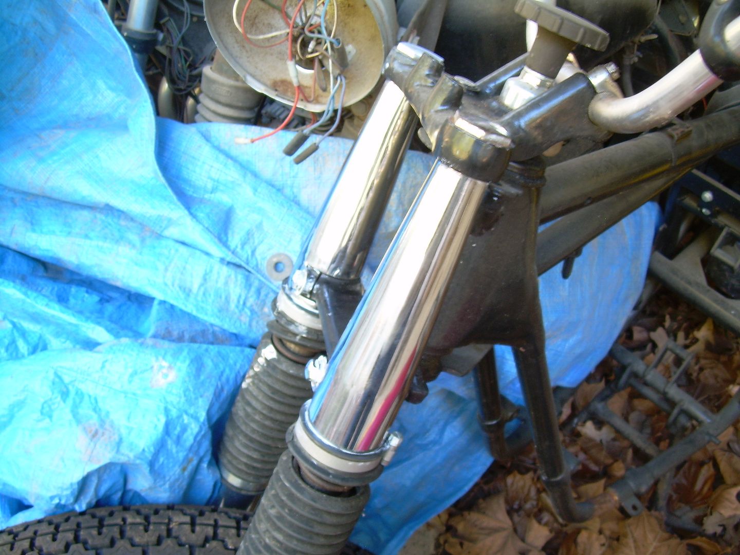

Well, I've cleared enough internal combustion projects out of the way so I'm now able to spend some time working on my '67 Hornet. Most everything is currently in boxes so I'll be starting from the frame up.
I disassembled the forks as much as possible to prepare for a rebuild. What is confusing me now is that my forks each have 2 internal springs that surround the fork damper rod (1 short and 1 long (sort of a progressive set up). The 1967 parts manual (pg. 52) does not show these springs. Am I missing something?
I've looked for detailed description of a fork rebuild, but haven't had any luck. I'll probably be replacing the fork tubes, seals and all misc. parts. Before I rebuild, do the lowers need any special treatment internally before reassembly? The damper tubes look good, are they typically re-usable? Finally, will I need any special tools to complete this fork rebuild?
Thanks for the advice!
Tom
Posted By: Gary E
Re: Hornet, Wasp, Spitfire Hornet, Cyclone (Restored) - 09/05/13 10:55 pm
Tom,
Can't visualize the 2 springs in there, but doesn't seem correct. You've looked at the spares manual page, so you know how it should be. To add to the page 52 diagram, there are 2 retaining washers (item #37) that sandwich the sealing washer (item #36). And Item #21 goes in the top of the damper tube (#8). It is confusing showing it at the bottom of the damper rod on the page. Also the oil drain screw (#11) aligns with a groove in the side (at the bottom) of the damper tube during installation. That keeps the damper tube from turning while tighning the bottom cap screw.
Fork seals are about all that needs tending to unless the 2 sets of bushings are worn to a point they need replacing. Not usually though. Make sure the bushing nut is tight when re-assembling. I've had to deal with a nut that was undone by a previous owner. Also insure that all of the parts to the damper valve are there and installed in the correct order and orientation. The fork tubes, as long as they are straight, are usually reusable. When re-assembling, good luck with the cap screw (item #15), that bolts the damper tube to the bottom of the sliders. They are oil leakers even with the aluminum sealing washer. So, apply some silicone seal to the cap screw before installing and hope you get lucky with no oil leaks.
The only special tool needed will be to tighten the oil seal holder. There are two notches down in it that a special tool is used to lock in place in the notches to tighten it. The tool can be purchased or make one. I made one from black plumbing pipe using a hack saw and file to make the notch pins, then welded a couple of big bolts to the top "T" style for handles. I use twine as a sealer of the fork seal holder and slide tubes as per the service maual, but some use silicone or similar.

Re: Hornet, Wasp, Spitfire Hornet, Cyclone (Restored) - 09/06/13 10:20 pm
Thanks for the details Gary and leon bee. I'll let you know how things go. I'm going to try to post a photo of the springs.
There was a set inside each of the fork tubes! The smaller spring was at the top. Am I even dealing with the correct pair of '67 forks to begin with?

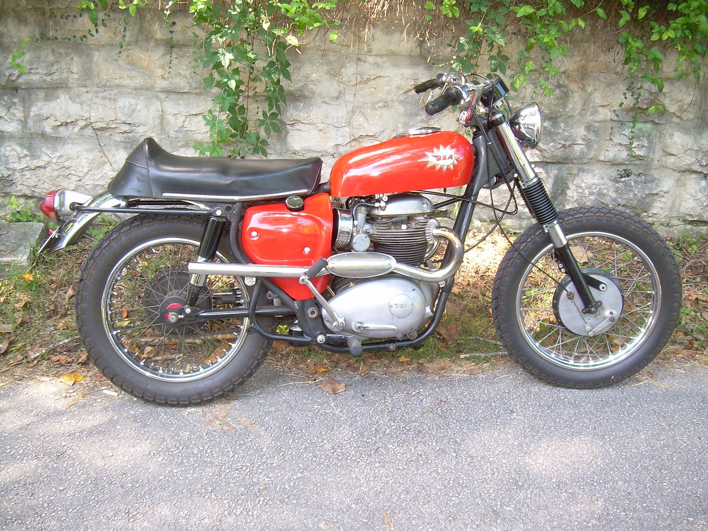

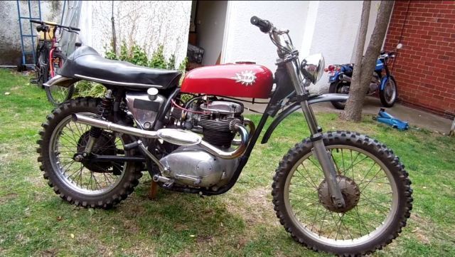

Posted By: SidSnot
Re: Hornet, Wasp, Spitfire Hornet, Cyclone (Restored) - 09/07/13 10:18 pm
Thats that one pretty much done!
Please dont mention the back arse wards transfer on the RHS tank. That fair slipped through to the keeper!
Otherwise fairly accurate me thinks.
I must admit this took me much longer than I thought. I had it roughly cobbled together for my bike show so I had to srtip it full down and start again from scratch. A 3 month job me thinks!!!Wrong, make that 12 months!
Sid
Posted By: Gary E
Re: Hornet, Wasp, Spitfire Hornet, Cyclone (Restored) - 09/08/13 5:47 pm
Very nice west coast model!
I see you opted to utilize the pipe heat sink collars. I like the way they look. They give the pipes a finished apperance.
There is a clip that attaches to the bottom yoke fork tube clamp bolt that holds the front brake cable up along the front fork assembly, so it isn't flopping around. Spares manual gage 50, item 13 (40-5090). You probably already know about it.

Posted By: Gary E
Re: Hornet, Wasp, Spitfire Hornet, Cyclone (Restored) - 09/09/13 10:54 am
Originally Posted By: tomkatohio
...I'm going to try to post a photo of the springs...
...There was a set inside each of the fork tubes! The smaller spring was at the top. Am I even dealing with the correct pair of '67 forks to begin with?
Tom,
Never seen springs like that in '67 forks. Post images of the rest of the fork parts, so we can identify whether they are correct for '67.
Re: Hornet, Wasp, Spitfire Hornet, Cyclone (Restored) - 09/09/13 10:54 pm
Following is a photo of the internals from one of the forks I tore apart. Both are identical (I added the double nut to remove the stud!). They're not very pretty!
I don't remember if the smaller spring was on top or bottom.
My "treasure" boxes did include parts from what is titled as a '67 Hornet (A65HA9445 frame and A65HA9445-Y engine) and some misc. Lightning parts (perhaps a '66) (A65L14820 frame). I only have a '67 parts manual. Could these possibly be the forks for the Lightning since I have two spacers with the headlight ears? I couldn't find any other spacers without the ears.
Posted By: Rich B
Re: Hornet, Wasp, Spitfire Hornet, Cyclone (Restored) - 09/10/13 7:55 am
Not sure what you have there. The forks were all very similar in that era for the unit singles and unit twins. There were some differences in stanchion length and lowers, but the rest was pretty much the same. External springs with damper rods internally.
The lower, damper tube, and fork seal holder are BSA bits. The rest....not so sure. Might have been a modification from back then or an attempted modification.
Re: Hornet, Wasp, Spitfire Hornet, Cyclone (Restored) - 09/10/13 10:17 pm
Thanks for the replies.
Damper Tube measures 11"
Damper Rod measures 21"
Slider measures 10" from top to base of cylinder (above axle hole)
Fork Shaft measure 28.75"
Posted By: Gary E
Re: Hornet, Wasp, Spitfire Hornet, Cyclone (Restored) - 09/11/13 1:53 pm
Can't help you on the damper tube or damper rod.
Fork tube: 22.5"
Slider tube: 10.25" center of axle to top (no threads)

thought I'd send an image of the now completed '66 Hornet I own...Another matching numbers Hornet saved from obscurity.
Thanks for posting the image of your Hornet. Another one rescued. What size front tire?

My pal bought a Hornet project with this tank on it. Somebody did a lot of work, I almost hated to undo it. I'm guessing the indents are sanded off this one:
Posted By: Gary E
Re: Hornet, Wasp, Spitfire Hornet, Cyclone (Restored) - 01/21/14 12:21 pm
"Bondo rod". Someone spent a lot of time modifying the tank back in the day.

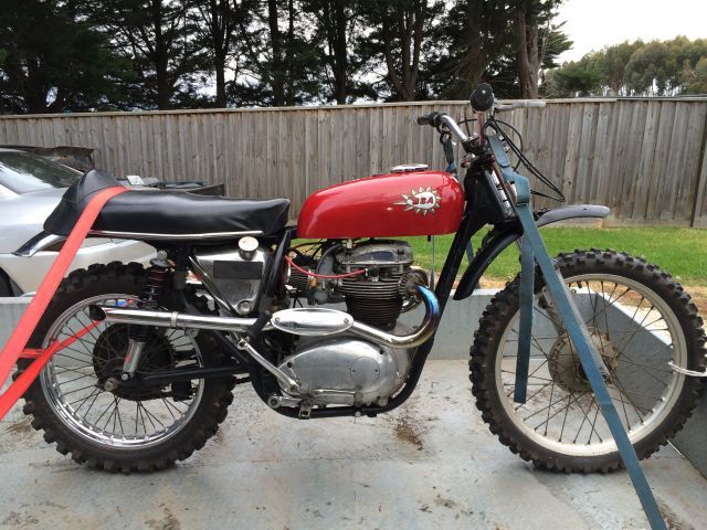

Hey guys, finally got the Hornet out of the Birdwood Museum here in South Australia (now I'm living back in 'civilisation') Have run about 200 miles on it since full rebuild and now playing with carb settings to get it running right.
Wanted to run some stuff by you blokes who are more in the know to see if I'm on the right track.
Carbs were initially supplied with 180 main jet, ran terribly...lumpy/stuttering pull at low revs, needing to be snicked up a gear to keep it moving and never really pulled above 1/4 turn in any gear. So, went up to 220 main...better but flat spot and stuttering appeared slightly higher in rev. range. Swapped out for a 280 and moved needle position to lowest ring on needle - still had some issues. Changed needle position to top ring and 280 main kept in...ran okay but would 'pink' on hillclimbs and lose power dramatically.
Now running a 300 main jet, needle on highest ring/clip position. Still pinking for first 30-40km's of ride on hills, but seems to calm down the longer I ride??? Have noticed throttle response is coming alive at higher revs and starting to pull harder as motor has loosened a little. Bike seems to come alive in 4th once I get over 55mph - from there on, it really wants to crack on. Albeit with one filter off (as it had fallen off during ride....) does it want better airflow thru the carbs too? Was running the standard old filter type.
I am running the straight through 'East Coast' pipes.
Will I need to play with needle jet settings, needle position again to iron out the pinking issues?
Forgive my ignorance, after running a relatively sedate (and crude) '67 Thunderbolt for years a twin carb, ope pipe beast is new to me. Loving it though - what a bike! The 2009 Triumph Street Triple R I also have has sat idle since getting both old bikes back on the road...much more engaging and enjoyable to ride and play about with.
Thanks in advance fellas!
Dave/POWDERWORKS/Adelaide, South Australia

You went from 180 main jets to 300 jets. That's quite a change. Original sizing for the Hornet carbs is 270 on the mains and the needle in position 4. So, you are not overly fat yet on fuel in the upper throttle positions. Kinda depends on what fuel you are running, what elevation you ride at, and what final drive sprocket you have on.
Also, having both air cleaners on, or the same of whatever for both sides is important to tuning.
Both Hornets and the Wasp here really come alive when they get up on the cam at over 4,000 RPM. They can pull the front wheel off of the pavement with not much effort.
As you know, do not load it up on the hills. Drop down a gear. Working it hard on the hills and getting pinging is a disaster in the making.

Still have the 280 mains and didn't feel much of a difference between them and the 300's to be honest. I think the bigger mains have ironed out the stutter but am thinking the pinking may be over advanced ignition (running a tri-spark set up). Have been told to back off the back plate slightly - will that be a counter clockwise rotation to retard ignition? Can't recall...been a while since I played with points, timing and the like.
The plugs pulled out reasonably clean after the weekend's run. A little sooty but no signs of running hot - electrodes fine, no 'ashy' residue.
I take your point about not loading it on the hills, keep them spinning has always been the advice I've had but was a little worried about over-revving a new motor. Will snick her down a cog on climbs now...I'd be a mess if I blew it this early in the relationship! hahaha!

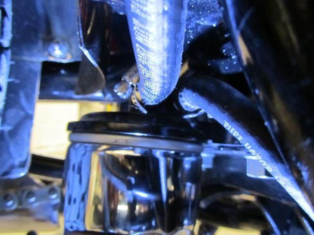

The hose coming out of the case near the OPRV goes into the oil filter. This oil is getting filtered. Its the hose on the right of this picture. The hose on the left is filtered oil and its going into the inner timing cover. The second picture shows the route of the filtered oil hose returning to the engine through the inner timing cover. Hope this helps. ljm

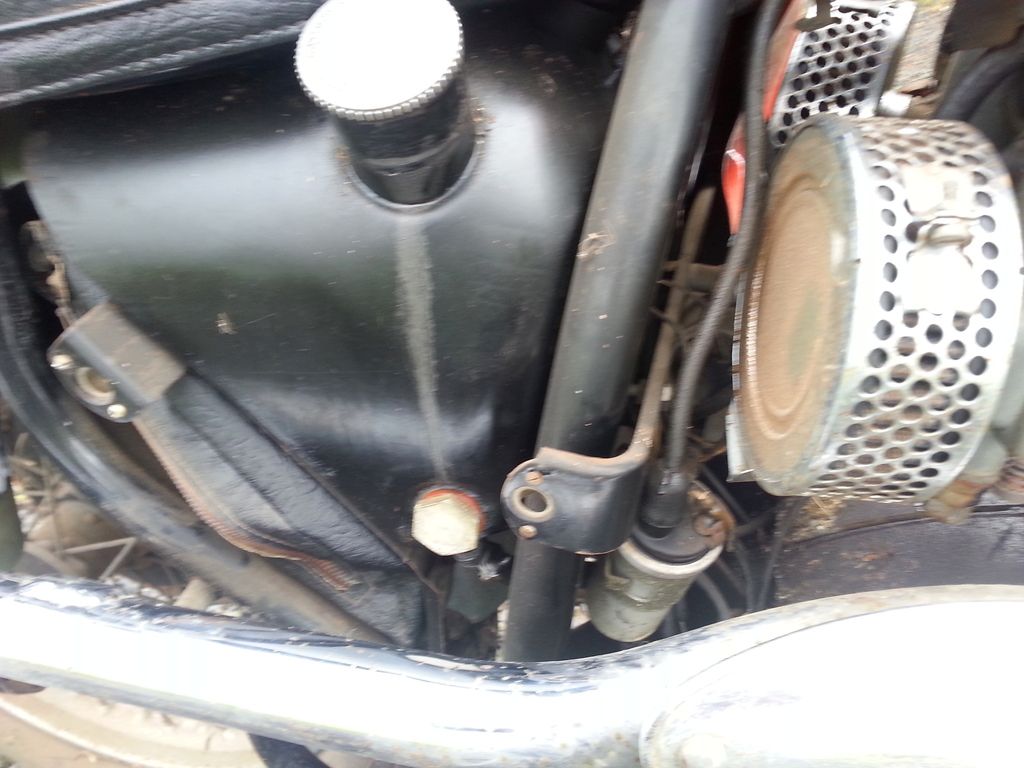

Hey Gary, from which pic can you tell it's not a WC frame? And isn't it worth maybe 4?
Posted By: Gary E
Re: Hornet, Wasp, Spitfire Hornet, Cyclone (Restored) - 11/18/14 5:29 pm
The picture showing the right side. The oil tank neck is short, typical of standard size oil tanks. The larger west coast oil tanks have a longer filler neck. Also, based on the answers to my questions from the seller, such as having a tool box, a 3.50 x 19 front tire, straight center fender brackets, WM2 front rim, and standard length fender stays. Most of those can be changed over the years, but the sure fire answer is the oil tank. It cannot be interchanged between the two different frames.
I suggested to the seller that he make a correction to the narrative regarding what model Hornet it is. As of today, he has not.

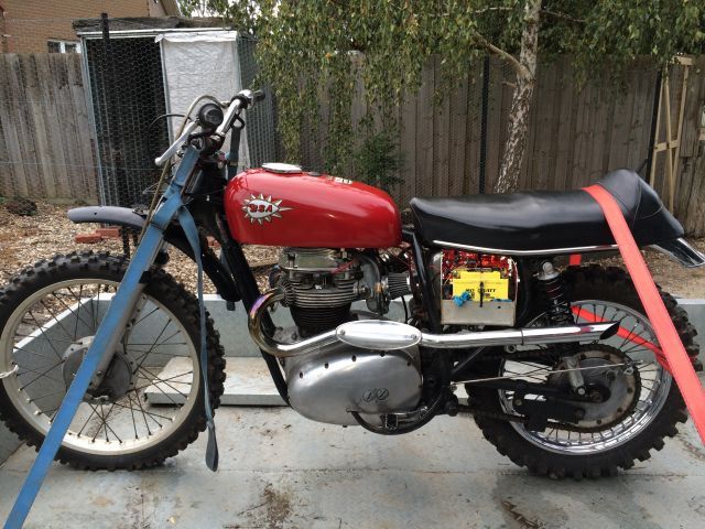

Time for an update!

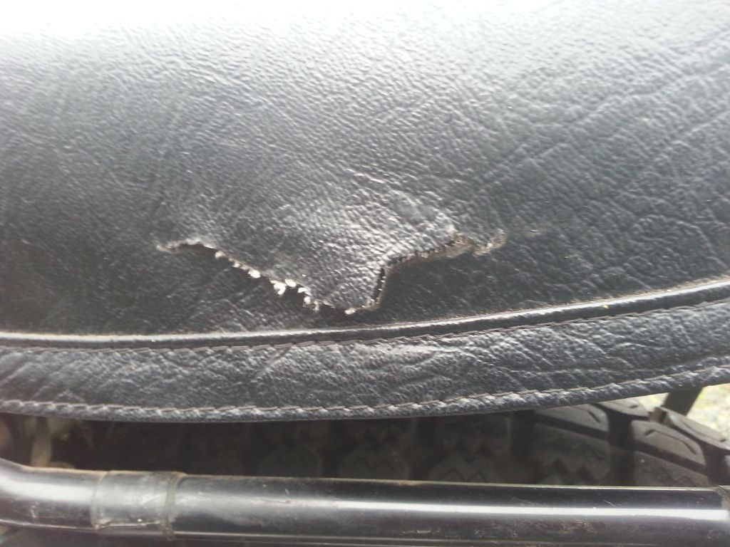

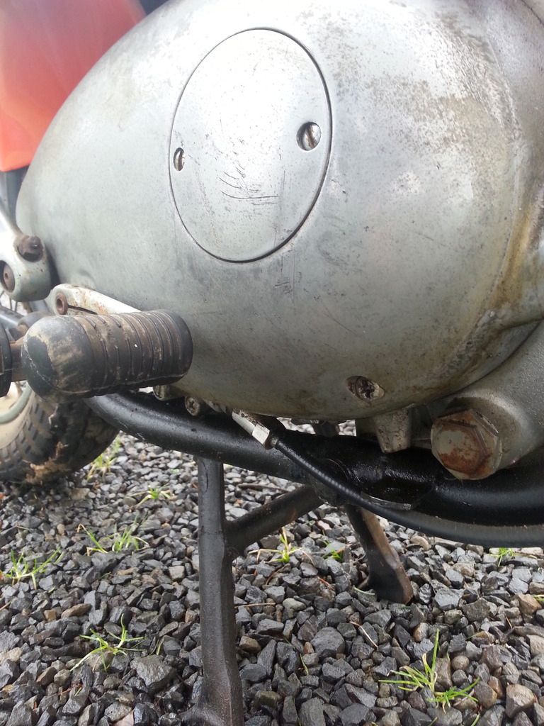

Warning to Hornet purists! This bike was never intended to be a resto project (just as well given what I found and what I am doing to it shocked ) so be kind.
Well I have had some time to poke around the Hornets innards and put some time in to make sure all was well before I took it out on the track for the first time.
Not pretty unfortunately but nothing that couldnt be fixed.
Gearbox was nearly out of oil. Replaced it.
Engine oil was reasonable for a test run will be changed after the first run.
Very limited steering lock to lock due to interference between the frame and the Honda triple clamps. (Dont know how previous owner would have even got around a track?) Picked up an old BSA set and with a bit of cutting and welding voila we have married the two together for a very nice setup.
Replaced damaged throttle cables and one incorrect carby throttle slide and adjusted.
Checked front and back brakes and added a rear brake return spring.
Checked all nuts/bolts were tight. (What a mess of various bolts that have been used!)
Fitted seat properly (only had 1 bolt in it), new plugs and was ready to go.

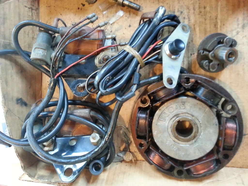

Tried to kick start but no luck. No spark. Went to check points and found it had a Boyer ignition fitted. Checked battery and it was low on volts so on charge for an hour.
And... fired first kick. No smoke and sounded pretty good.
By this time mates on a couple of Tribsa's and a custom Beeza 500 were already blasting around the grass track.
Joined the fray and had a real blast. It runs like a dream and sure is a handful to hang onto at full noise! Man does it get hot though. Not enough air flow and have to limit runs to 3 or 4 laps and then a cool down.
Post fun day improvements.
Dropped all the oil and cleaned out the tank. Installed a cartridge oil filter and replaced all the oil hoses with new. Ready for the next ride.
While the exhaust pipe was off i saw the full extent of the damage to the pipes. Lots of dents and the rear bracket has rubbish weld all around and is in the wrong location.
Next mod will be to tweak the electrics and get rid of the battery followed by methanol kits for the carby's.
Ado

Gary,

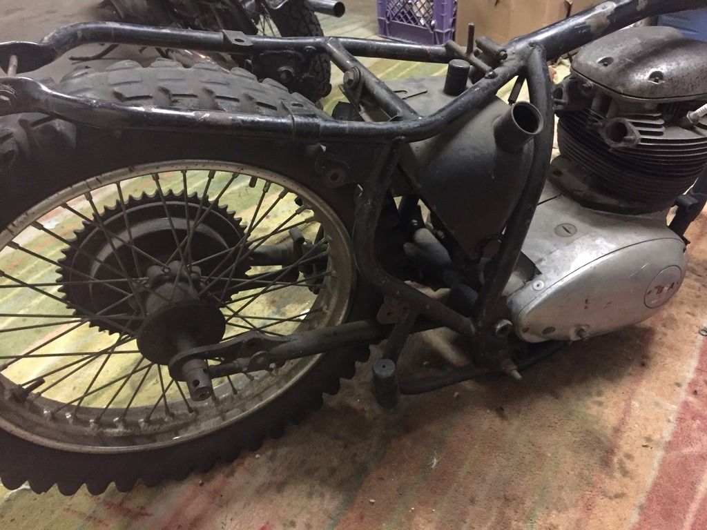

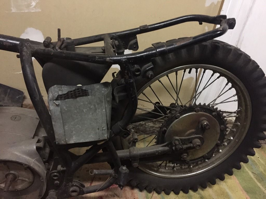

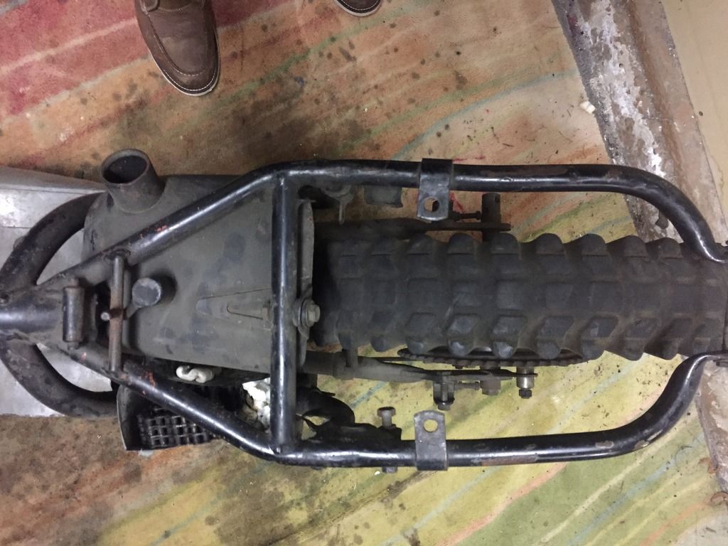

I have been dabbling with my Hornet pile. I am fairly certain the rear fender is Hornet (short at the rear) but it is not dimpled for the tool box to fit. Sound like any Hornet fender you have run into?
I want to run side over...not above "modifying the tool tray......
Posted By: Gary E
Re: Hornet, Wasp, Spitfire Hornet, Cyclone (Restored) - 10/18/15 10:14 pm
The first image below indicates the length difference of the Hornet fender compared to a standard. The actual length distance is dependent on the shape of the tail end. Some are more pointed than others.
The second image shows how many different rear fender types there are, on just the left front portion. The top example of the four has no indention, with the bottom three having various shapes of the indention for the battery tray. And the Hornet (& Wasp) didn't use a battery tray. As a result, it doesn't surprise me that your fender may not have an indention where you indicate.
Posted By: Rich B
Re: Hornet, Wasp, Spitfire Hornet, Cyclone (Restored) - 10/19/15 5:15 am
Thanks....the ident I was looking for is RH side for the tool tray. But none of your examples appear to have the dimple on the RH side either.
Posted By: Gary E
Re: Hornet, Wasp, Spitfire Hornet, Cyclone (Restored) - 10/19/15 9:30 am
Yes, I don't have any pics of the right side differences. Just was showing that there are several styles of rear fender even though the part number is the same for them.
Posted By: Gary E
Re: Hornet, Wasp, Spitfire Hornet, Cyclone (Restored) - 10/19/15 11:02 am
And of the 6 rear fenders here, 5 have the right indention, one does not.
Posted By: Rich B
Re: Hornet, Wasp, Spitfire Hornet, Cyclone (Restored) - 10/19/15 12:04 pm
Details, details...... laughing
So it is a "typical" Hornet fender in my pile"
Posted By: Gary E
Re: Hornet, Wasp, Spitfire Hornet, Cyclone (Restored) - 10/19/15 12:11 pm
It is as long as it is the short length and has never been trimmed. Hornet/Wasp (Spitfire Hornet/Cyclone too) fenders do not have the wire harness loops underneath, nor the large wire harness loop hole (for the harness grommet) up front left side.
Posted By: Rich B
Re: Hornet, Wasp, Spitfire Hornet, Cyclone (Restored) - 10/19/15 12:19 pm
Short, never been trimmed, no hole for wire harness grommet, no support loops for harness, no dimples for battery box or tool box.
But the chrome sucks and over the years it has suffered the indignity of extra holes added to it. So it needs some cosmetic surgery.....
Posted By: Gary E
Re: Hornet, Wasp, Spitfire Hornet, Cyclone (Restored) - 10/19/15 12:32 pm
It's a good candidate for a Hornet, Cyclone, Spitfire Hornet, and the elusive Wasp. I do know about extra holes. That sample pic previously of the Hornet fender had 12 extra holes in it.
Years ago, I sent a Hornet fender to the chrome shop for hole filling and a re-chrome. I circled the holes to be filled with a felt tip marker and included written instructions. Got the fender back all nice and re-chromed with the original mounting holes (even the ones with doubler plates on the underside) brazed shut and the holes to be filled wide open. I called them on the phone and I could hear them in the back ground blaming each other for the blunder.
Posted By: Boomer
Re: Hornet, Wasp, Spitfire Hornet, Cyclone (Restored) - 10/20/15 5:44 pm
So what would one expect to pay for a decent, not quite perfect, Hornet rear fender?
Posted By: Gary E
Re: Hornet, Wasp, Spitfire Hornet, Cyclone (Restored) - 10/20/15 6:20 pm
Depends on what "not quite perfect" is. If there are cracks that would bring it down. Dents down not as much. Extra holes to be brazed shut, not as much down as dents. Quality of the chrome doesn't matter much (unless the fender is a real cherry) as the fender will likely get re-plated. I sold the one in the previous image for $180. It had 12 extra holes, no dents, no cracks, all of the mount hole doublers were in place, and the rear rolled edge was fine.
What it looked like when I rescued it.
Posted By: Boomer
Re: Hornet, Wasp, Spitfire Hornet, Cyclone (Restored) - 10/21/15 12:08 am
Chrome is nice, two small dents by mid mount holes. Two small holes, maybe 3/16", just above rear mounting holes. No cracks and no cuts with pointed rolled end. Pics to come.
Posted By: Semper Gumby
Re: Hornet, Wasp, Spitfire Hornet, Cyclone (Restored) - 12/03/15 10:48 pm
Hi Gary,
I have come in possession of what looks like a fairly complete West Coast Hornet Frame. A65HA.8914
It has the large oil tank and all the tabs excepting the side stand lug. There are no tabs for the Hornet pipes on the back of the frame. There are dangling from the aft foot peg lug two longish pieces of metal which when turned up look like to be the right height for exhaust support. Also there are two shorter pieces from the same place that are perhaps TT pipe supports????
Here are pictures.
Exhaust supports?
It has a Bates headlamp installed bracket down which dented the front fender (arrgh)
Here is the oil tank which has the Odie clips. It looks like a wren made its nest inside!!!!
There are 4.00X19 K70's front and rear although the rear wheel looks to be off a Lightning Rocket (Narrow 19" rim like my 1964.)
The back one is worn out but the front one has good tread but is prolly unsafe for the track. Did I say track?
So tell me what I have I got? One the back is a 68 or 69 tail light assembly minus the lense. The fenders are rusted but look re-chromeable. As I said the Bates dented the top of the front fender but the rear fender is complete and un-cracked!
The winter project begins....
Posted By: Gary E
Re: Hornet, Wasp, Spitfire Hornet, Cyclone (Restored) - 12/03/15 11:22 pm
Nice one Bill. Great find. I do not have that number in my '67 Hornet registry data base. It's been added.
The bracket you have your 2 fingers on, the one with the rounded end, is a rear exhaust pipe mount for the Hornet west coast TT pipes. It likely has a slight bend to it at one end. The mounting holes at each end are oversize to allow for mounting adjustments to the typical BSA "not a very accurate fit" system of parts. The other longer bracket doesn't look to be a BSA part. There weren't any tabs on the west coast frame for mounting the pipes. The inside of the pillion peg mount is where that TT bracket mounts to (as in your image).
Correct oil tank for west coast Hornet. Is there a small "L" shaped bracket at the rear lower area of the west coast tank for mounting to the threaded boss which in the frame? If so, good, as they are a bit rare to source. I've had to make a few for other WC Hornet owners.
The front fender, stays and center brackets look to be correct west coast. The rear fender would need to be shorter than a standard (lightning, Thunderbolt, etc.) fender to be the correct fender.
A lot of potential there.
Re: Hornet, Wasp, Spitfire Hornet, Cyclone (Restored) - 12/03/15 11:29 pm
So West Coast Hornets only had the TT pipes? I believe the there is a L shaped tap on the lower outside of the oil tank connecting it to the frame. Yep its there. It is hard attached to the tank and then the tab splits around a robber grommet which is bolted to the frame?
What was the stock rear wheel and rim size?

Posted By: Gary E
Re: Hornet, Wasp, Spitfire Hornet, Cyclone (Restored) - 12/04/15 1:26 am
That's the correct oil tank mount tab then. Only west coast Hornets had the large oil tank. The frame is also specific to west coast model, as the oil tank saddle of the frame is different.
Rear wheel size is the same as all other A65/A50's: Jones 42-6361 WM3x18 with a Dunlop Gold Seal K70 tire. That tire is still available.

Posted By: Gary E
Re: Hornet, Wasp, Spitfire Hornet, Cyclone (Restored) - 12/04/15 9:40 am
The front rim to be a west coast would be a WM3x19 Jones 68-5558, not common to source. So, wider than the typical standard WM2x19 mounted on the east coast Hornet and other A65/A50 models. The west coast Hornet front tire is a 4.00x19, larger than the east coast Hornet 3.50x19 and other A65/A50 models 3.25x19. The 4.00x19 Dunlop K70 is no longer made, but there are NOS ones out there.
The Jones rim numbers are stamped in, so a little chrome polish or an SOS pad and water might clean the rim in the number stamped spot to see what you have.
Having the correct front fender, stays and brackets is a biggie. Nice find.
Re: Hornet, Wasp, Spitfire Hornet, Cyclone (Restored) - 12/04/15 12:02 pm
The front rim is wider than the WM2 on my Firebird next to it. So there is a good chance this is the original tire! I have access to another Hornet frame I will scarf the correct bits off. The rear axle came off an OIF I suspect and is loose and hanging out the right side. On a good note the rear drum spins freely but the brake plate is frozen. The rear sprocket is worn down to the nubbs. Prolly driven till it wouldn't go and then left for dead.
Posted By: Gary E
Re: Hornet, Wasp, Spitfire Hornet, Cyclone (Restored) - 12/04/15 12:30 pm
Yes, the rim does look to be a WM3. The front fender looks like it is on backwards.

Posted By: leon bee
Re: Hornet, Wasp, Spitfire Hornet, Cyclone (Restored) - 12/05/15 12:34 am
I actually got rid of a couple bikes this year. Traded this one to my old pal Bob:
Edit: realized tank wasn't level right after I took the picture.

Posted By: leon bee
Re: Hornet, Wasp, Spitfire Hornet, Cyclone (Restored) - 12/06/15 8:48 pm
Got enough to do one more Hornet. Got this engine I was building before getting distracted by off topic bikes:
Got these:
An almost perfect A50 frame:
And up here is some pipes and tanks and seats:

Hi Gary,
Saw your Three Tenors video. Very nice. I was wondering what set up you have for that electric starter? I am wanting to build something like that. I pick up my Hornet project tomorrow. Just frame and motor and a few bits.
Posted By: Gary E
Re: Hornet, Wasp, Spitfire Hornet, Cyclone (Restored) - 11/15/16 1:31 pm
Originally Posted By Roadwarrior
Hi Gary,
It is based on the Doc Z roller package with several modifications made.

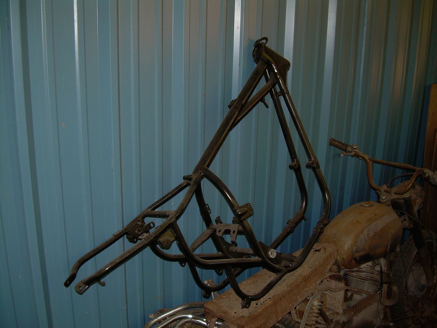

Here are a couple pics of the oil tank mounting.
Posted By: leon bee
Re: Hornet, Wasp, Spitfire Hornet, Cyclone (Restored) - 11/21/16 8:52 pm
West coast maybe. Check page 2 of the old original thread:
Tried to link to it, didn't work. But it's on page 2.
Posted By: Gary E
Re: Hornet, Wasp, Spitfire Hornet, Cyclone (Restored) - 11/21/16 9:47 pm
As I suspected from the numbers you provided it is a west coast model frame. There is most likely a threaded boss in the frame on the right side for the oil tank rear mounting (blocked from view in the second image).
I will enter it in my '67 Hornet registry data base as a west coast Hornet.
The west coast oil tank is larger than the east coast model and is specific to the west coast model frame. The oil tanks are not interchangeable. All that info is in the first few pages of the 64 page original thread.
Other west coast model differences include a different front fender, its stays and brackets, wider front rim, larger front tire, and different exhaust pipes (TT pipes) and pipe mountings. All of that info is also in the 64 page thread.

New to the group. Just got a 1965 BSA Hornet project. Pretty much a frame and engine at this point. You can see from the picture. But has a lot of potential. Looking for parts, can anyone point me in the right direction? Need big things like, tank, seat, exhaust pipes etc.
They seat mount was modified. Has anyone see anything like this before? I included a picture below. Im thinking it was for a desert style racing seat?
1965 Hornet
Seat Mount
Thanks!

I don't know anything about the desert sled models but the rear of that frame loop just doesn't look right.

If it is a '65, then it would be a Spitfire Hornet.
Some parts will be especially difficult to source. Original '65 Spitfire Hornet high pipes are quite rare as they are different than '66/'67 Hornet pipes.

That frame number indicates it is an early 1965 Spitfire Hornet (the '65 numbers started at 4001). Frame and engine number in '65 are not matching, so the engine number would be different. Supply that number and we can indicate what year the engine is.

You are correct, it is A65HA 13878. How can you tell it is an east coast model?
Thanks!
It has the standard size oil tank.

Okay, got it home and unloaded. Here's some pictures of my, new to me, '65 Spitfire Hornet.
Obvious things are the lights and shorty muflers have been added. The gauges are wrong and the wheel rims rusty. Later finned valve cover. Electrics have been switched over to 12V coil/battery. Abox with all the original AC ignition came with it. It's been in storage since 1990 but the engine still turns over.
Posted By: Gary E
Re: Hornet, Wasp, Spitfire Hornet, Cyclone (Restored) - 01/21/17 4:53 pm
You did good. It looks fine. Mostly original. That kill button and the mount are hard to source.

So the tank needs repair. Unfortunately it looks like it got punched right where the left emblem decal would have been. I've heard and read about all the nightmares of the fiberglass tanks but seeing how this is original I would like to try and repair it. So I'm looking for a good fiberglass repair guy.
i bought the bike from the son who inherited it from his dad that did all the changes. When he or someone that was helping him move it they put the small tear in the seat. Too bad as it is a really nice original seat with a really clean pan and good foam.
There are two gauges and the speedo is driven off of the gearbox. Is this something added? I thought A65's were driven off the rear wheel and that Hornets just had tachs.

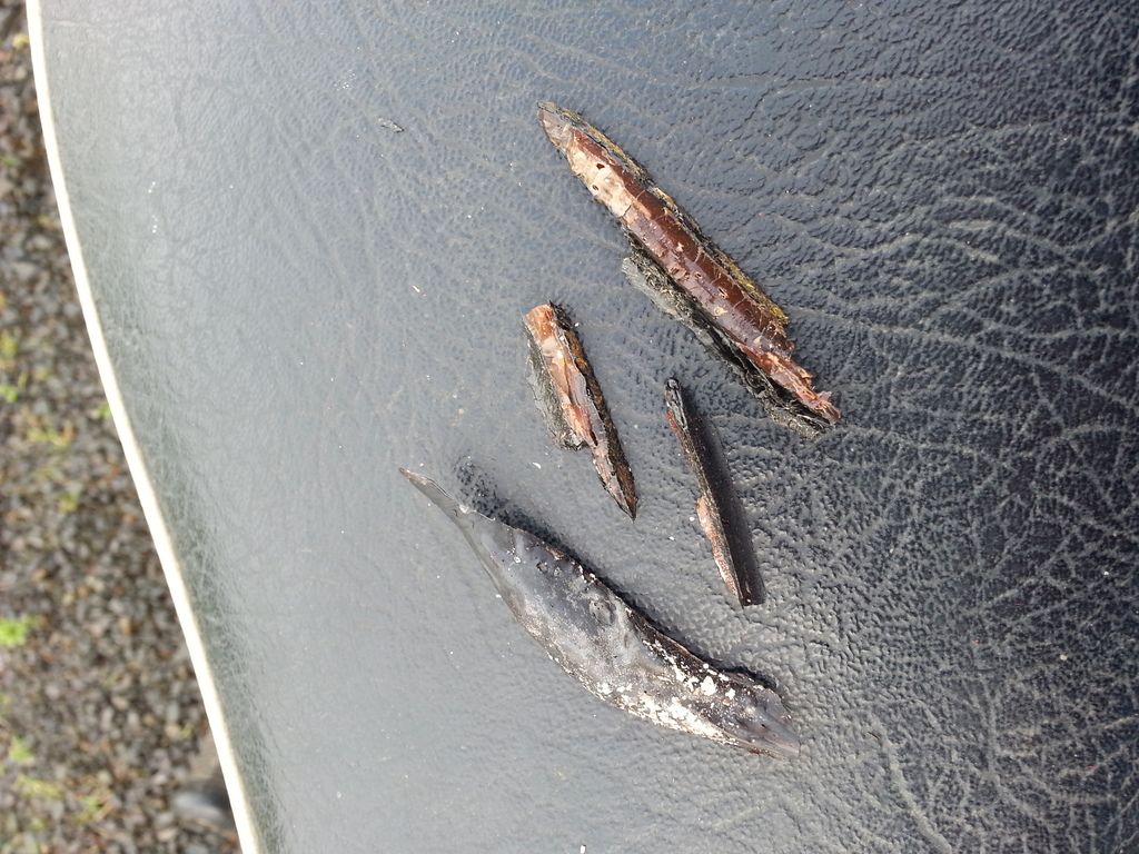

When I took the tank off there was something rattlinng around inside. This is what came out.
The 12V ignition was done rather nicely at the time with all Lucas parts, coils, rectifier, capacitor and the setup looks like it was taken off a britbike or all original parts off the shelf.
The handle bars have been changed out but apparently is was easier to keep the cables attached to the throttle twist and choke cables. Here's the remnant of the cable guide that was mounted on the original bars. It's under the duct tape.

Re: Hornet, Wasp, Spitfire Hornet, Cyclone (Restored) - 01/21/17 8:22 pm
No speedo originally on Spitfire Hornets.
Pieces from inside the tank are not uncommon. It's just left over resin or gel coat when the tank was built. Likely if you were to flush the tank with acetone and sheet rock screws, a bunch more would come out.
Looks like the original Spitfire Hornet wire harness got changed out to one for lighting and traditional coils/battery.
The kill button and mounting plate are original.
The primary chain engine sprocket is different on Spitfire hornets than standard. And there is a timing disc between it and the rotor that is not on standard models.
Looks to have an original Spitfire Hornet rear fender which is a real plus.
And those original air cleaners with outer dust guard are hard to find. I have a pair hanging on my shop wall.
Carbs look to be non-handed originals.

Great Hornet! This one is my dads in FL, it is also a 1965. Not nearly as stock. Any idea what forks are on this one? I know they aren't stock. He needs to rebuild them so we are trying to find out.
Was the kill switch mounted on the left side opposite of the oil tank? When my dad got this Hornet it had a toggle switch there for a kill switch. He replaced it with one on the handle bar. See a picture below.
Posted By: Gary E
Re: Hornet, Wasp, Spitfire Hornet, Cyclone (Restored) - 01/23/17 1:07 am
On a Spitfire Hornet the kill button is mounted to a triangular plate which in turn is mounted on two of the top yoke handlebar bolts.
Hornets ('66/'67) is a button mounted in a chrome holder direct to the handle bar.

Re: Hornet, Wasp, Spitfire Hornet, Cyclone (Restored) - 01/23/17 3:45 am
Those leading axel forks look to be Spanish or maybe Italian make. Your top tree has a provision for a fork lock that wasn't present on a Hornet.

Spanish forks are Bultaco. Possibly the wheel too. I'm no expert.
Gary E.
Just to clarify the statement about air filters. Was that style with the cover fitted to Hornets? What Years?
Posted By: Greg J.
Re: Hornet, Wasp, Spitfire Hornet, Cyclone (Restored) - 02/01/17 5:55 pm
I believe they are Betor. The only marking on the forks is a thumbs up.
Posted By: shel
Re: Hornet, Wasp, Spitfire Hornet, Cyclone (Restored) - 02/01/17 6:35 pm
They look Bultaco to me, the the Thumbs up is a Bultaco thing

Thumbs up stamped in the legs are sure sign of Bultaco. A fair number of Bul and Betor fork parts can be swapped around........

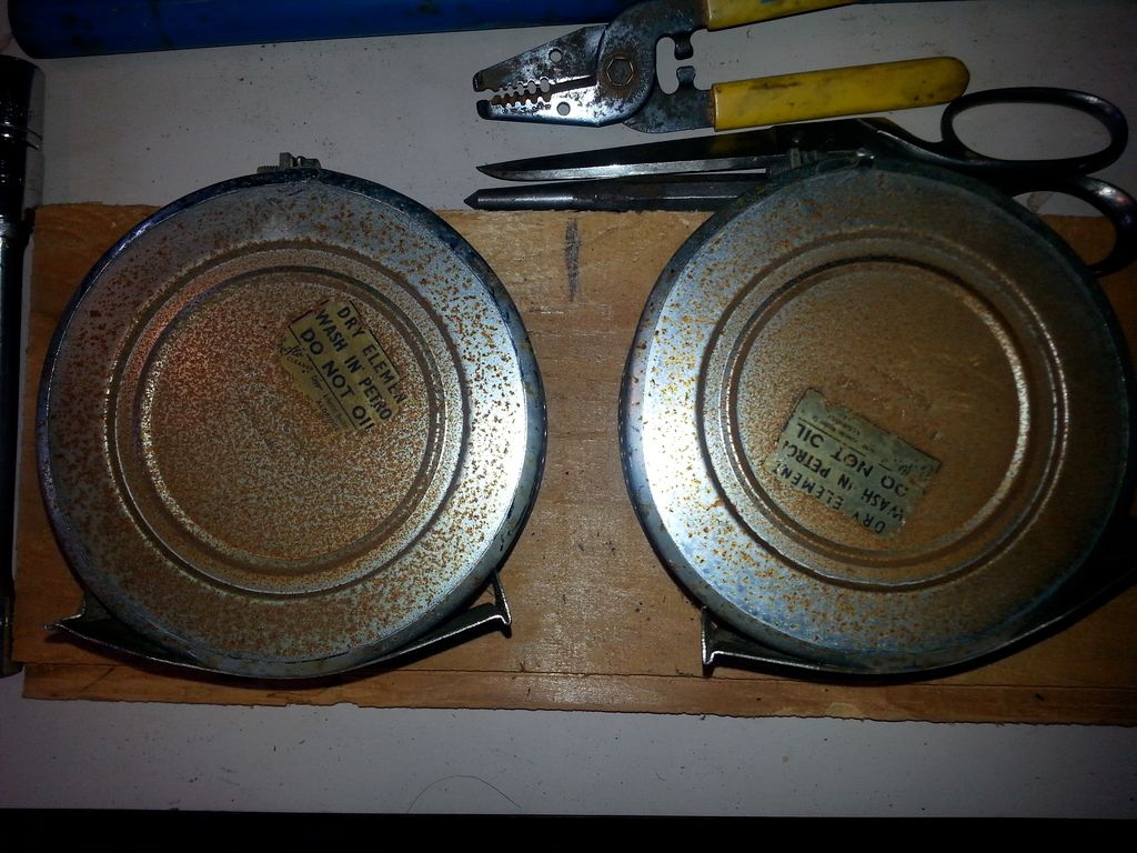

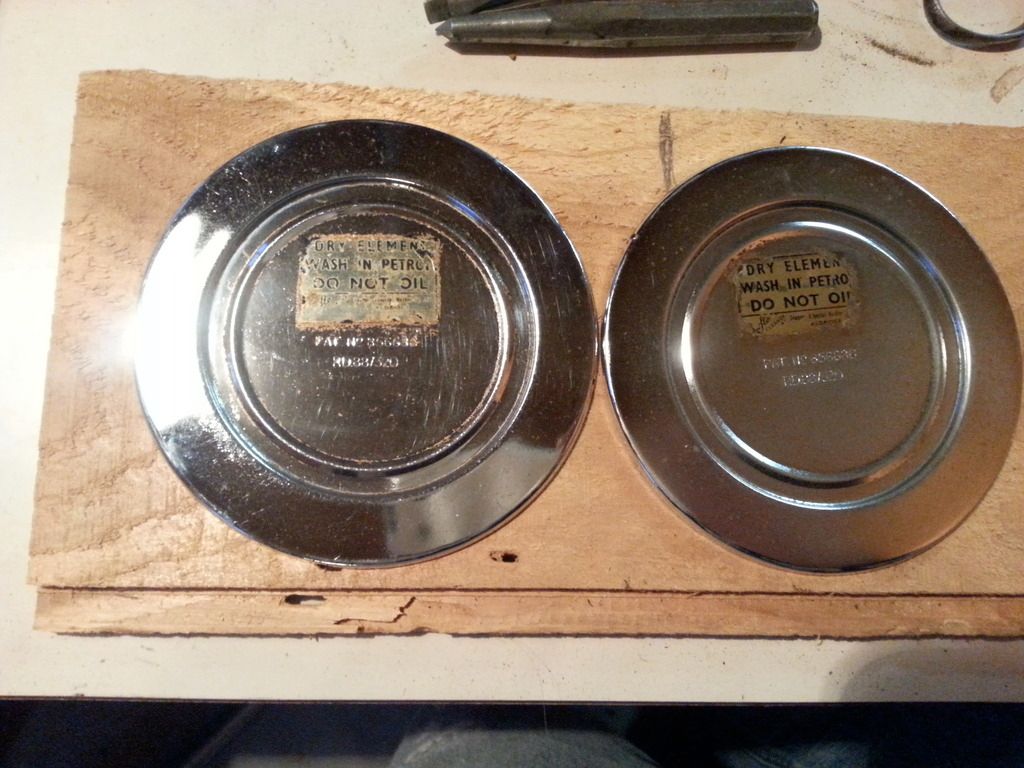

Gary E.

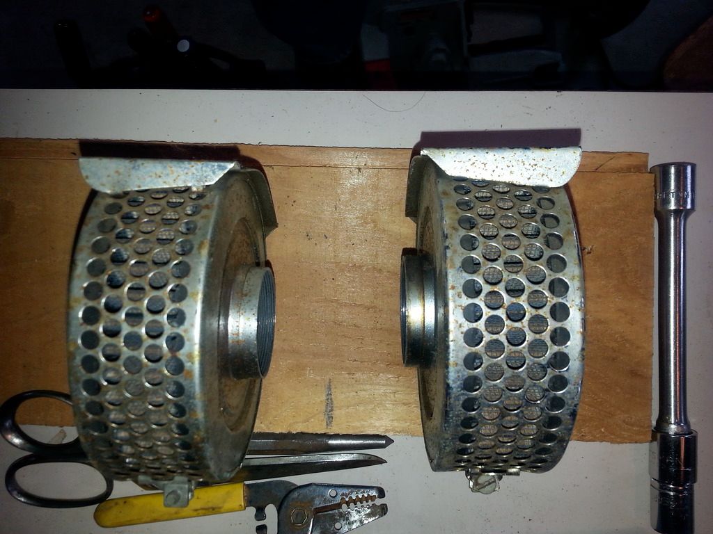

A closer look at the air filters.
Covers after a little clean up.
Posted By: Gary E
Re: Hornet, Wasp, Spitfire Hornet, Cyclone (Restored) - 02/03/17 11:35 pm
They don't get any more original than that. Complete with the original decals. Replacement original looking decals are available.

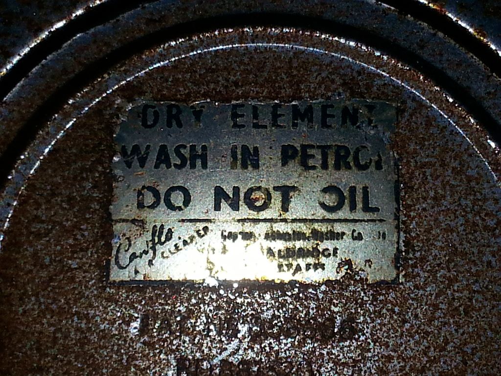

So I'm trying to figure out the field in the air filter decal. Is it silver/chrome like, or clear, or maybe even a faded gold?
I've seen this decal on other filters and they could be black with gold lettering, or white with black lettering, and gold with black lettering. So which is it?

Here is what Classic Transfers has to offer for Conflo air cleaners.
http://www.classictransfers.co.uk/transfer-category/conflo/?region=british-us&alphabetical=a-c
Posted By: VicCyclone
Re: Hornet, Wasp, Spitfire Hornet, Cyclone (Restored) - 02/05/17 10:53 am
Go with the R/H filter in your picture above. I have 2 pairs of these filters NOS in the wrappers. The backing field is faded gold with black lettering. Unfortunately none of the classic transfer offerings matches this, however from personal experience they will make transfers to order.
Good luck
Posted By: Gary E
Re: Hornet, Wasp, Spitfire Hornet, Cyclone (Restored) - 02/05/17 11:33 am
Good luck
Good one Vic. I have had Classic Transfers make custom stick-ons. The last one they made for me was for the Wasp tank.

Posted By: BrizzoBrit
Re: Hornet, Wasp, Spitfire Hornet, Cyclone (Restored) - 02/08/17 4:46 am
Gary,
Thanks for the update on the filter fitments. So for '66 flat back, black painted air filters then?
Posted By: Gary E
Re: Hornet, Wasp, Spitfire Hornet, Cyclone (Restored) - 02/08/17 10:38 am
Originally Posted By BrizzoBrit
Gary,
'66/'67 were chrome filters on the Hornet and Wasp.

Posted By: SidSnot
Re: Hornet, Wasp, Spitfire Hornet, Cyclone (Restored) - 02/12/17 4:15 pm
So Gary let me just clarify that. For 66, the front and the back plates are chromed as well obviously as the perforated bands?
Sid.
Posted By: Gary E
Re: Hornet, Wasp, Spitfire Hornet, Cyclone (Restored) - 02/12/17 4:38 pm
Sid.
The '66/'67 air cleaners had black front and backs and chrome perforated bands. The '64/'65 Spitfire Hornets had chrome fronts, backs, and perforated bands.

What is the difference between the US (68-6536) and the UK (68-6535) variants of the 6 tab front guard and the one specified for a 66 Hornet 68-6544?
Posted By: Gary E
Re: Hornet, Wasp, Spitfire Hornet, Cyclone (Restored) - 02/18/17 11:46 pm
Thanks Gary.
Next question.
The UK 68-6535 has mounting holes on top along the centerline of the fender for the UK style long curved vertical license plate "crotch slicer").
The 68-6544 is fitted to '66/'67 west coast model Hornets. It has the 6 tabs that are splayed out at more of an angle (about 45 degrees) for tire clearance. The west coast front tire is the large Dunlop Gold Seal K70 4.00 x 19, so it needs more clearance than the standard 68-6536 east coast model Hornet fender that has the 6 tabs in a more vertical position for the mounting of a 3.50 x 19 K70 tire. The 68-6536 is also what is utilized on all of the other same year A50/A65 models.
The west coast model also uses a wider rim, the WM3, for the large 4.00 tire, as opposed to the standard WM2 rim on the east coast model for the 3.50 tire.
Images and narrative of the front fender differences as well as tire sizes (3.25, 3.50, 4.00) are contained in the original 64 page thread with the thread link provided by John in the very first post of this current thread.

The more I dig into these front guards the more confused I seem to be. Both the 66 and 67 parts manuals show the front guard stays going over the top of the guard and I am guessing these are the UK version?
Virtually all images of 66 and 67 (even west coast) show a standard stay that bolts straight to the guards front tab.
When setting up my 66 front guard it seems to sit way too high with about an inch of daylight (probably over 2 inches of actual gap) between the guard and the 3.60 tire. On a recent trip to my local bike breaker he gave me 3 says of differing length.
The stays I have are 12 inches between the bolt hole centers. Strangely these are the same on my 67 West Coast but according to your old post on page 6 (Restored) Gary the WC are longer.
What are the length please of the East Coast ones and does anyone have a 66 parts book image of the standard setup with numbers? I also had about 5 front guards there and there seems to be a great variance in guard radius and tab positions.
Sid
Posted By: Gary E
Re: Hornet, Wasp, Spitfire Hornet, Cyclone (Restored) - 03/07/17 2:45 pm
The manual drawings depict the front stay that applies to the Spitfire, regardles of whether it is export or UK. There is no manual drawings of the straight style front stay. For the east coast model Hornet (as well as all of the other model machines, except the Spitfire) the front stay length, as well as the rear stay, the length is 12 inches (center of hole to center of hole). The stay is straight. The west coast model Hornet stays (all 4 of them) are 12.5 inches hole-to-hole and have one end that is slightly bent. Same with the center bracket and tab; the west coast brackte is bent on one end for the 4.00 tire clearance and the fender tab is bent outward.
East coast stays = 12 inch length, straight end, 3.50 tire, all fender tabs are straight (fender is the same as all other model machines) (stays are the same as all other model machines except Spitfire)
West coast stays = 12.5 inch length, bent end, 4.00 tire, all fender tabs are bent out (stay usually has an "H" stamped on one end)

Having a Bit_ch of a time timing the ETS on my 67 Hornet. I followed all the instructions on aligning the rotor with the peg plate, setting the points, but I can't get any spark at all. Even went through Magneto Man's excellent thread on it. And I just think I figured out why. It has a Triumph ETS rotor, not a BSA ETS rotor. It has the Triumph 3 holes S, M, R, and three extra that someone put in.
Does anyone have an extra ETS rotor I can buy for the BSA Twin? Or, will the Triumph rotor work? The "S" hole on the rotor is 37 Degrees BTDC, which is the same as the "R" hole on a BSA rotor.

I had several ET rotors, all with recharged magnets, but sold them off last year.

Bob, are you sure it's the rotor? I would think even at 37 degrees you should be getting a spark, but I'm just learning about these A65's and my '65 Spitfire Hornet had been converted to DC coils so I'll be watching this thread more.

He talks about it. The Hornet is timed at 37 degrees. I had the pin in the "R" hole in the back of the stator per the workshop manual. The "R" hole in the Triumph stator is at 41 degrees. I think I can use the Triumph stator if I use the 37 degree hole marked S. I would rather use the correct one for the hornet. I tested my stator as best as I could, and it seems ok. Maybe it's got a problem. The points have to open at exactly the point where the stator is producing maximum voltage in order to generate the spark. At 4 degrees difference (41-37) I think the points won't be open when the voltage is at max. That's what I understood from Magneto Man's thread.

John Healy gave me these values on a BSA rotor with the 3 holes S=37 degrees BTDC
M=39 degrees BTDC
R=41 degrees BTDC
I used the S hole for the ET. Don't know if the triumph is different.
Posted By: Gary E
Re: Hornet, Wasp, Spitfire Hornet, Cyclone (Restored) - 05/13/17 10:29 pm
Good info Leo. The shop manual indicates to use the "S" hole.

Re: Hornet, Wasp, Spitfire Hornet, Cyclone (Restored) - 08/11/17 12:34 am
I'm getting to the point of installing the front end onto my frame...
Got to the point of installing the damper assembly, and I need to ask; the connection to the frame for the steering limit plate, is it just supposed to be a flat bar?
And isn't the plate supposed to go above the flat bar?
My frame seems to have two "fingers" sticking up, 90 degrees from the plane of the bar.... These will not let me mount the plate above the bar.
Help!?
Re: Hornet, Wasp, Spitfire Hornet, Cyclone (Restored) - 08/11/17 10:37 pm
Sounds like you've got the wrong damper plate. The flat one (same as A10) only fits frames up to 1965. The later one is turned up 90 degrees to match the "fingers"
Posted By: Gary E
Re: Hornet, Wasp, Spitfire Hornet, Cyclone (Restored) - 08/11/17 10:49 pm
None of them are flat. All have bends and curves in them. The correct one has a bolt welded at the back of it. The best view of the proper one is in the '68 Spares Manual, page 48, item 30, part number 68-5185 (anchor plate). The '66/'67 Spares Manual has the old style shown.
And the Friction Washer goes on top of the anchor plate along with the special Spring Washer.
Posted By: Rickman
Re: Hornet, Wasp, Spitfire Hornet, Cyclone (Restored) - 08/12/17 2:36 am
Thats interesting Vic,
I have one of those for my '69.... and there aren't any fingers, it's a full loop with a slotted hole so the 90 degree plate can be slide adjusted...
Another interesting thing I've found; there are at least 2 different "flat ones"... I have both...
Is that "special spring washer" the 'star' shaped one? Or something I'm still missing?
Posted By: Gary E
Re: Hornet, Wasp, Spitfire Hornet, Cyclone (Restored) - 08/12/17 12:31 pm

Posted By: Gary E
Re: Hornet, Wasp, Spitfire Hornet, Cyclone (Restored) - 05/21/18 9:10 pm
Thanks for the info on the two machines.
Unfortunately, neither bike is very original. Neither one has original factory BSA TT pipes, and both rear fenders have been bobbed. Those two items are very hard to source. The eBay bike looks to have Triumph style TT pipes on it.
