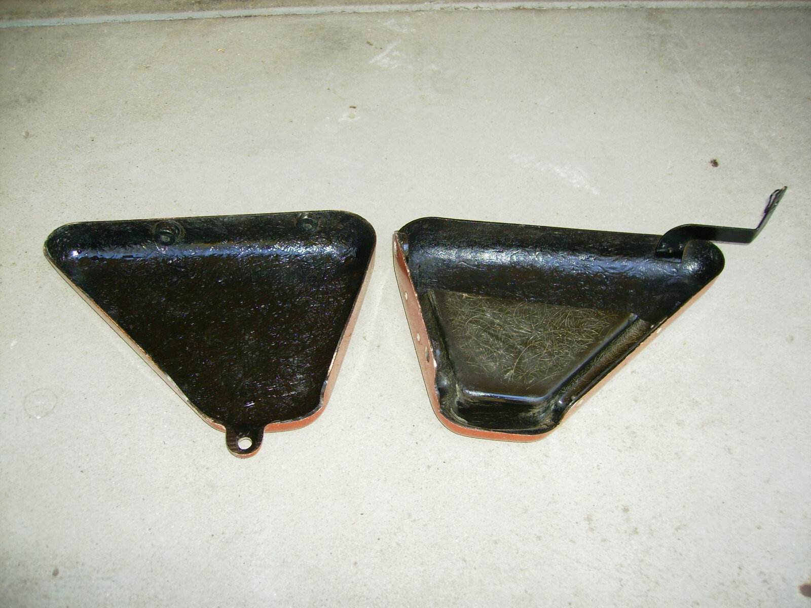

750 tanks/sidecover sidecovers in steel or fibreglass appear to be almost a subject on their own ?
[Linked Image from static.mijnwebwinkel.nl]
Back of a pair of Fibreglass 850 FireFlake Golden Bronze sidecovers
