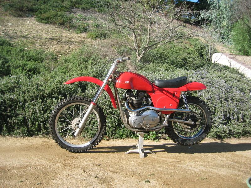

Manx
My Rickman Mk III has the larger "desert tank". It is wider but not really much taller.
I hope the photo gives you a sense of what the larger tank looks like, from the side at least.

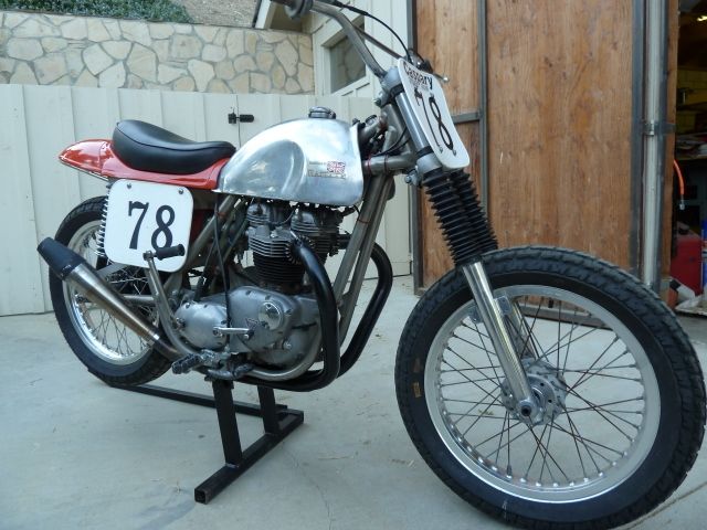

Manx
Same Mk III but with alum tank - not as large capacity as the original fiberglass tank in first photo though.
[img:left][Linked Image][/img]

I am going to jump in - the smaller style alum tank on my Rickman (#78 photo in this thread) is from Terry.
Been racing it for over 5 years - no issues - I installed with proper foam support to make a snug installation.
